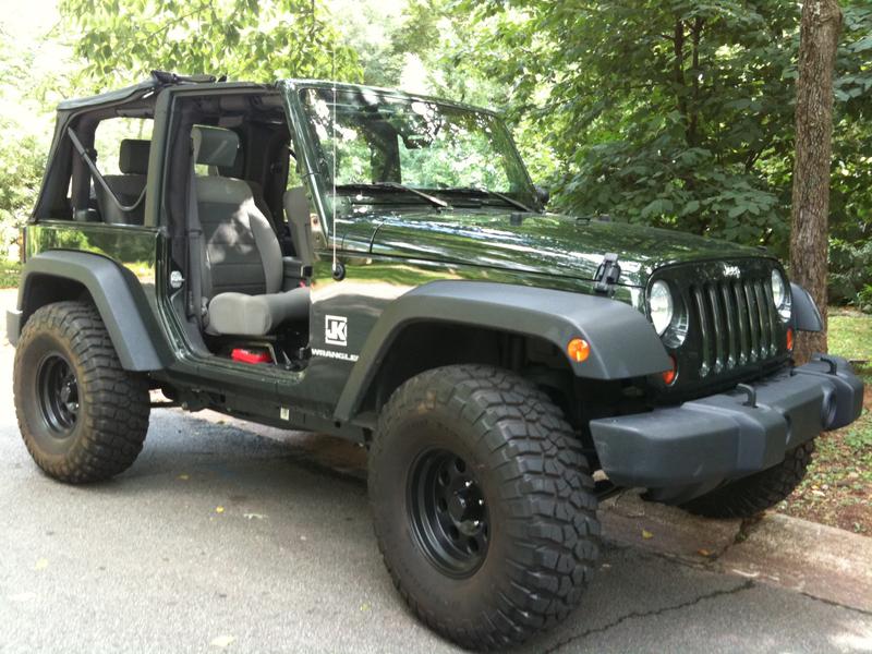

Old Sep 21, 2011 | 03:56 PM
mumbling1's Avatar
Joined: Nov 2009
Posts: 63
From: Decatur, Georgia
Originally Posted by JKU 4x4
MB72 3.75 back spacing on mine, clears no problem
Mine fit perfectly as well. MB72 from Discount Tire Direct. Great customer service as well. (no.. I'm not affiliated!)
It's all about the proper backspacing.
Good luck.
Here's the link to where I bought them:
http://www.discounttiredirect.com/di...r=1&wd=15&rw=8
On my JK:
