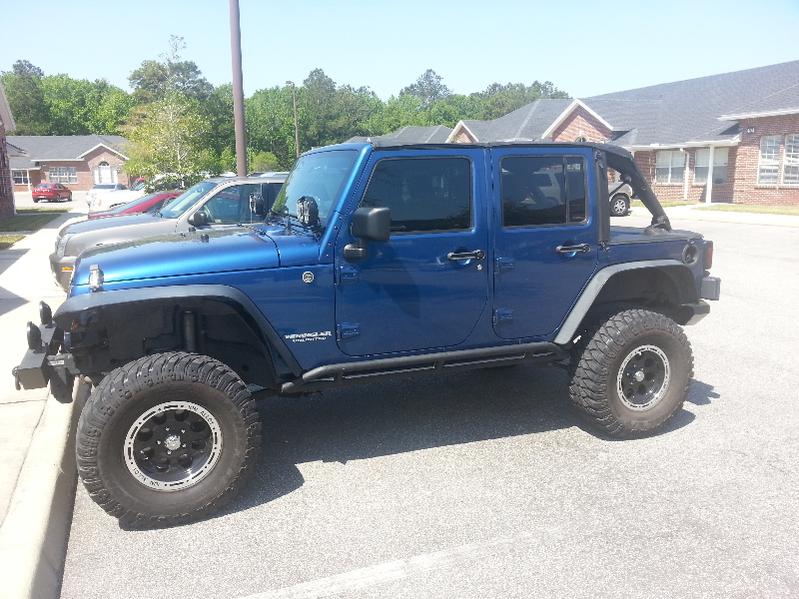

I've got a 2010 JKU with Auto and factory 3.73 gears running Rough Country 4" lift and Cepek 35" MT's.
