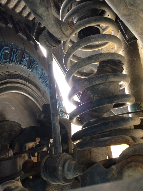

So looking at my Jeep last night, I see this.
Broken bump stop in the spring.
Old Jan 30, 2017 | 08:40 AM
OverKill's Avatar
Vet Army
Posts: 950
From: Cadiz, KY
Is it broken or fell out? Maybe fell out, because they did not insert it in properly or all the way.
