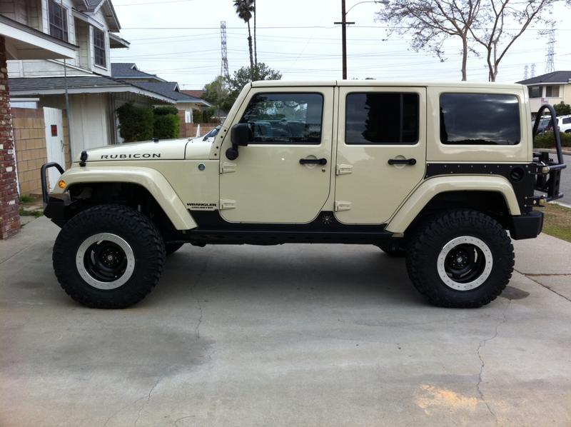

Default Update Picture after the lift/tire/rims
Here is an updated picture of my jeep. Rock Krawler and ORE are assisting me with having everything dialed in.
Still have to put on the spare, winch, Poison Spdyer 3rd brake light, ARB Compressor w/ EVO 2012 under the hood bracket.
Old Dec 14, 2011 | 08:12 AM
Paradise's Avatar
Posts: 180
From: Ft worth, tx
Looks great! What tire carrier is that?
