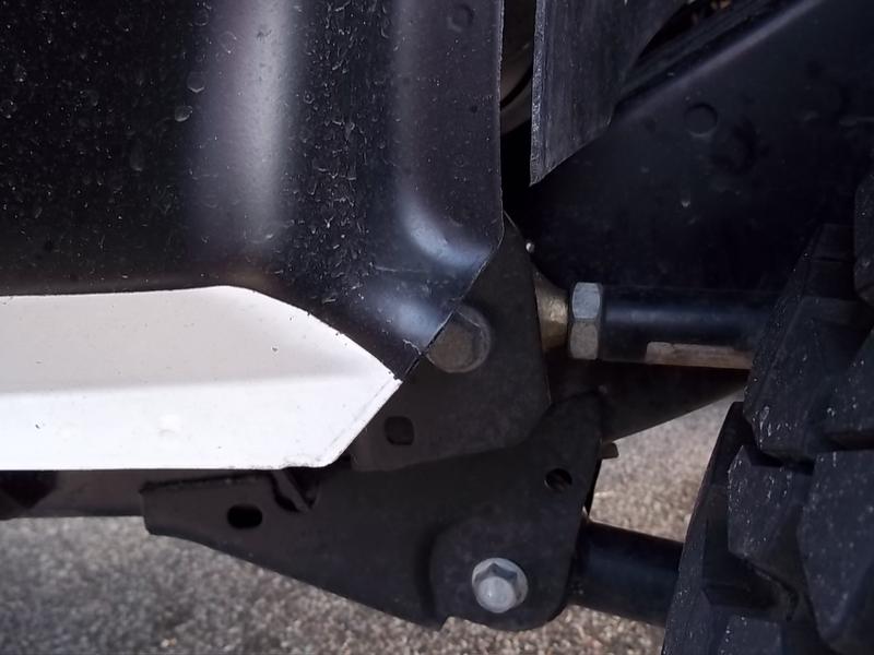

I also run the TF spacers with a 3" FT lift, which netted me 4". The ds boot does contact at the shock bottom out point, but that does not ahppen that often on the trails. THe rishk is well worth the coin saved between the Y pipe and the spacers in my opinion. I prefer to run adj trackbars in the front and rear because it makes it easier to recenter the axles. I dont trust the relo brackets for track bars as I have seen too many of them fail. Those wheels will be fine with 35s. May want to look into trimming your pinch seams in the rear

Mattgt5
Thanks for input.....What do u mean by trim pinch seams?sorry newb here.
Its a little metal piece of the frame that sticks out beyond the side steps or what ever you have on your jeep. This little piece of metal can slice your tire so you kinda have to trim it.. sorry not with my jeep currently so I can't take a pic. I'm sure someone can get a picture of it for you though. Oh yeah, this is in the rear wheel wells.. forgot to mention that >.<

Look at the bottom of your rear wheel well, front side, right behind your rear doors whre the panles are pinched together. it is at a right angle and protrudes into your wheel well. A 35 will hit this during flex, can cause a flat. Here is a picture of mine trimmed, dont have one of what they looked like originally, but it will be just like yours.
