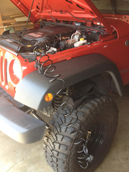

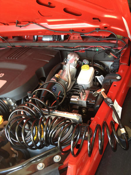

I went with the Jeepswag basic OBA system.
I believe they're going for about $200 on sale right now?
Super clean setup an easy install.
Works great for me and its pretty cheap.

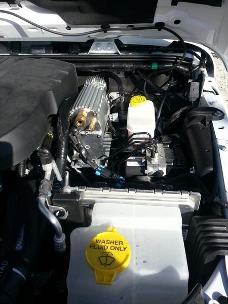

So I got my OBA system installed and running real nice now. I wound up going to west marine and getting a marine grade on off key switch to run instead of the tiny little toggle supplied. This also insures that it gets shut off as the key for the on switch is located on my key ring and the only way to remove the OBA key is to have it in the off position. I also wired in an inline marine grade waterproof fuse then covered all the wires in matching factory harness wire covers and shrink wrapped all of the connections.
The synergy mounting plate bolted right up without any issues at all. You need to push one of the AC lines to the side to make everything fit and not rattle but that was really a non issue. I had to relocate my brake booster vacuum line as well but that was a short trip to Napa for two feet of vacuum hose and a little time to cover it with harness dressing to make it look factory as well. It is very disappointing that ViAir cant figure out how to make a bracket for the 2012 plus. I mean that is there primary product and after two years now they cant get a bracket made?
Either way the pump is really very nice and having a constant duty pump just makes me feel better about the system then knowing that I have 20 mins before the pump is going to overheat and shut off. I think the next project is going to be to add a six gallon pancake tank where my stock muffler was and route it so I can use air tools off of the back using a remote connector off of the compressor. Click image for larger version
