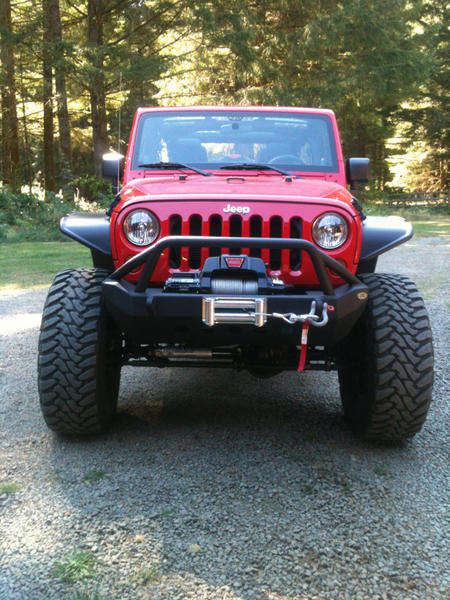

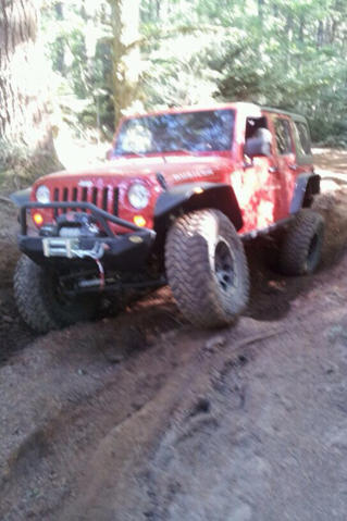

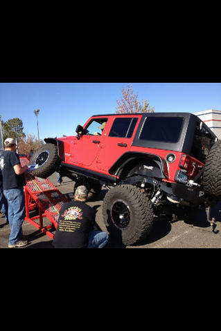

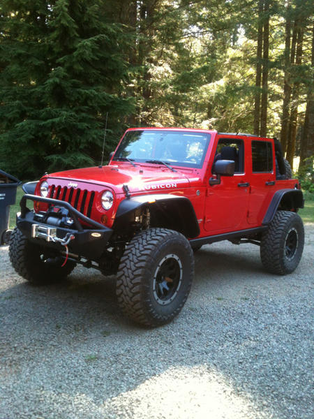

Jpop: I'm running 38" (37.7) on my 2012 jku, auto, would like to know your opinion on my gear choice? My Rubicon is my DD, I live in Oregon so it's a mix of hilly roads, flat ground and altitude of sea level to 4000'. I love wheeling but I would put my self in the moderate range as far as wheeling! Mostly camping, fishing, hunting & trail riding! Not a big fan of carnage, but don't mind watching someone else do it ;-)! Any ways I read a lot of you post and would like your feed back ;-)

Jpop: leaning more towards better economy, and I have 3.73 ;-( now! I'm tired of my auto searching for the wright gear to get into?
