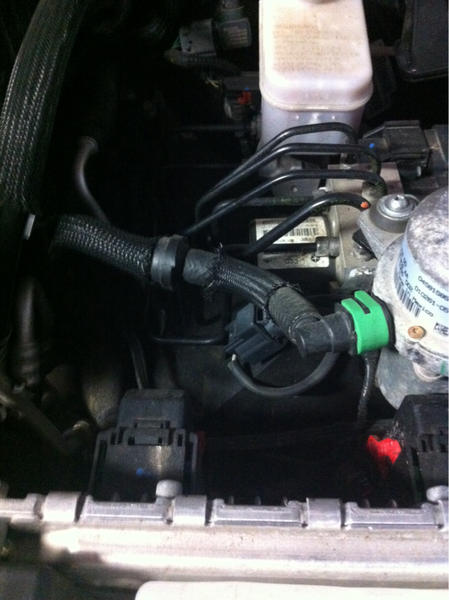

I am getting ready to replace the OEM front bumper on my 2013 JK. I noticed that it is a bit different than my old 2011. There appears to be some sort of vacuum module on the underside of the bumper on the drivers side that was not there on my 2011. Just wondering if this will be an issue on the new bumper install?
I have looked at several bumpers, and have not noticed any statements to that effect, but have been down this road before.

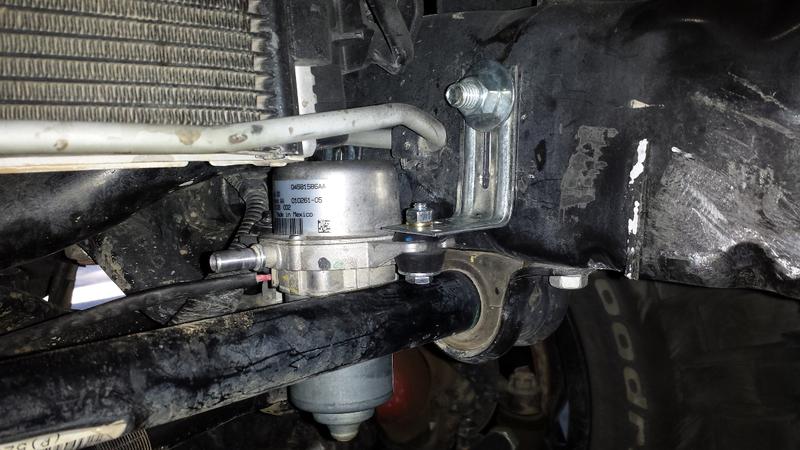

Most aftermarket bumpers will require you to relocate the vaccum pump. I recently had a warn rock crawler stubby bumper that came with a relocation bracket..but they are some companies out there that make one too. Offroad Evolution, Teraflex and Or-Fab all have there own style of brackets.
Here in this pic, I relocated mine using 2 angled truss brackets from home depot for $1.60 and the bolts and selftappers I already had. I moved the pump on the other side of my electric sway bar cuz I purchased a poisonspyder bfh front bumper which requires you to cut 2" off the frame rails so the bumper is tucked closer to the body.

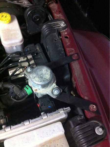

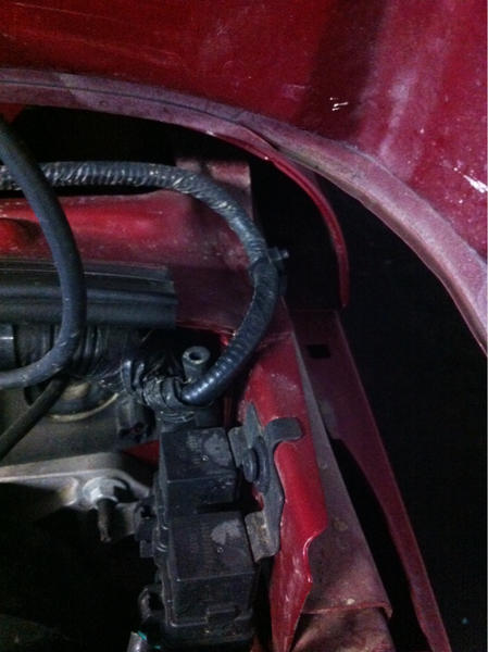

I relocated that up under the hood when I put my winch in there with my stock bumper. Just have to make up a bracket or buy one, shorten the vacuum hose and extend wires. Not to difficult. Here's a few pics.
