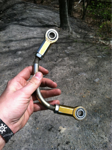

If you have very long shocks your sway bar links can flip around backwards(see pic of bent link). That's the only difference I can see in this guys sales pitch.
I debated limiting straps but decided to just put longer links in and see how that goes.
