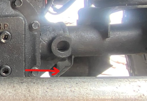

It's a little hard to tell from those pictures, but I am leaning towards a factory axle. Here are a few things I notice.....and this is not to say that maybe TF design hasn't changed over the years.
This looks like a factory lower control arm bracket to me -
TF puts their badging here, but this might have changed -
This is a Synergy TB bracket, which would not be necessary with a TF axle that uses their own beefy bracket -
This one throws me off a bit cuz this doesn't appear to be a factory sway bar bracket -
Can't tell what is going on right here but this looks odd -
There's not a great shot of the C's, but they should be a dead giveaway vs. the C's on a factory axle. Also, look at the closure/skid on the lower control arm bracket. The upper C on a TF axle should appear much beefier than factory. -
It's just a little hard to tell from the pictures supplied.

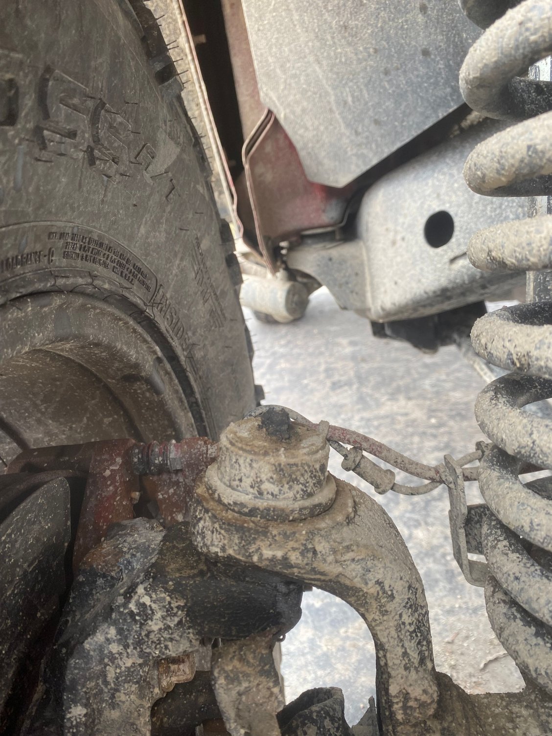

Thanks for the detailed explanation! I know the Jeep has an Evo manual sway bar disconnect now.
I just took some pictures of the C’s and ball joints. Sorry it’s so dirty. Just got a good snowstorm up here at 10,000ft.
If the axle is stock I will look into C gussets and also beefier ball joints if those look stock to you as well.

this angle is helpful. i can see that is just a bracket by the spring to hold brake line, and that this bracket by the yellow arrow looks to be the factory with the red arrow bracket just being a means to lift the sway bar link. So odd to me they'd put the kind of money into this jeep for control arms and fancy shocks, and then not be willing to buy nice, longer, sway bar links. Make no sense to me.
The ball joints look like they have a grease zerk on em so those are aftermarket, but can't tell under all that much what brand. Even the Moog "OEM quality" once have a zerk. Factory BJs have no grease zerk at all and are not "serviceable". I can't tell on the bottom BJ, but TF has a unique zerk design on their bottoms. Considering how much TF stuff is on the jeep you might take a look at the TF BJs and compare.
I feel about 98% certainty you have a factory rubi44 front axle there.....but I'd leave myself room to fall down. I am just looking at a few pictures.
