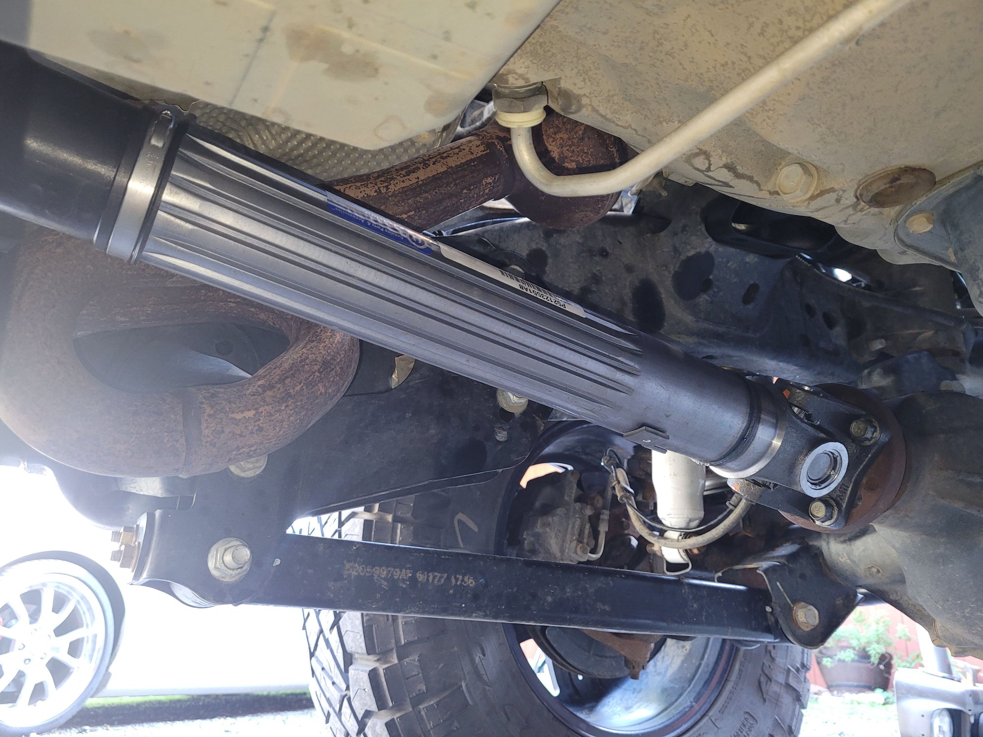

As request here are a few shots of the Suspension. Some attention is certainly required out back and I might be wrong but those Sway Bar Links seem to be adjusted too high!
Thoughts and opinions welcome:
New Front Drive Line...

So those sway bar links are adjusted WAAAY too long. You want that sway bar parallel to up just a few degrees. Shorten the links up and you won't be hitting the frame anymore.
Gssh those rear springs have a good bit of rust, and definitely aren't matching. I see now why you were considering just a whole different kit. Considering you would like new shocks, I can't blame you for wanting matching coils. Pictures speak a thousand words. You have a raised rear TB bracket which most kits will come with, quick disconnecting sway bar links which is nice, and those control arm brackets. New shocks and springs would go a long ways. Outside of that, extended/new brake lines are nice, but not necessary, vs using those little brake line drop brackets. The front TB looks factory.

I have the links off and was waiting for this reply. I have an email back to Rubicon Express requesting the part number that would match the new front 2.5's. Given the cost of coils and a good set of Bilstein's and an adjustable Track Bar I will probably end up with a nice lift.
On the other hand a complete kit with Short Arms isn't that expensive compared to what they used to be. If I understand the short arm lifts they don't use the Drops correct? A complete short arm kit would give me some missing components and freshen up some that are lacking. Lastly the front Drive Shaft is new... and I've read that these should be replaced with anything over 3.5" due to the risk of contact during flex. Is this a solid concern or should I just run with it the way it is.

HI, I'm going to jump in... the picture of the shocks have AEV stickers .. AEV uses Bilstein shocks.. the GC brackets look to be AEV.. and the springs being 2 stage could very well be AEV.. AEV is a very good company and have very good lifts.. Check the top of the springs for numbers.. AEV has contact them via email on their web site.
Could not tell if it is a 2.5" or 3.5" lift.. with the numbers on the springs you could email AEV and perhaps they can identify..Adjust the sway bar links ,, drive it see how it rides/performs. I'd get on AEV's site, check out the 2.5" Dual Sport Lift and the 3.5" lifts.. look at the components and the numbers.. you might find the answer as to what lift is on your ride.

Just took it for a drive after the sway links have been adjusted. On the bright side I have plenty of vertical adjustment if I ever want to go taller. I turned them all the way down and literally only made one turn to get them on and you can the Sway Bar is still a bit high. When driving I noticed the suspension felt more balanced in the front. Less pull on the opposing side when I hit a deep bump. Not sure what the dealer was thinking when they installed these? That said I am on the right track. Heading over to AEV to check it out
