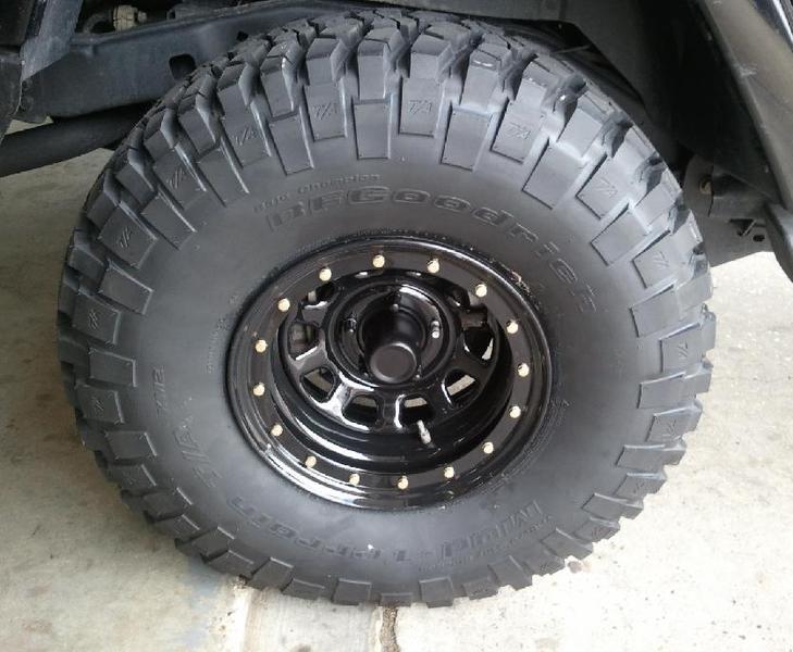

I've yet to dial in, The off road shop started with 35 PSI, after a couple days of driving I've noticed the outer tread hairs were still on, I could still barely see small lumps in the interior treads, so I went down to 30PSI, it rode smoother but still saw the outer tread hair things. I'm gunna try 25 PSI to see if I can get it to ride flat. I know turning will be affected but I kinda want an even wear. If u got a programmer u can cancel the low air warning light on the dash.
