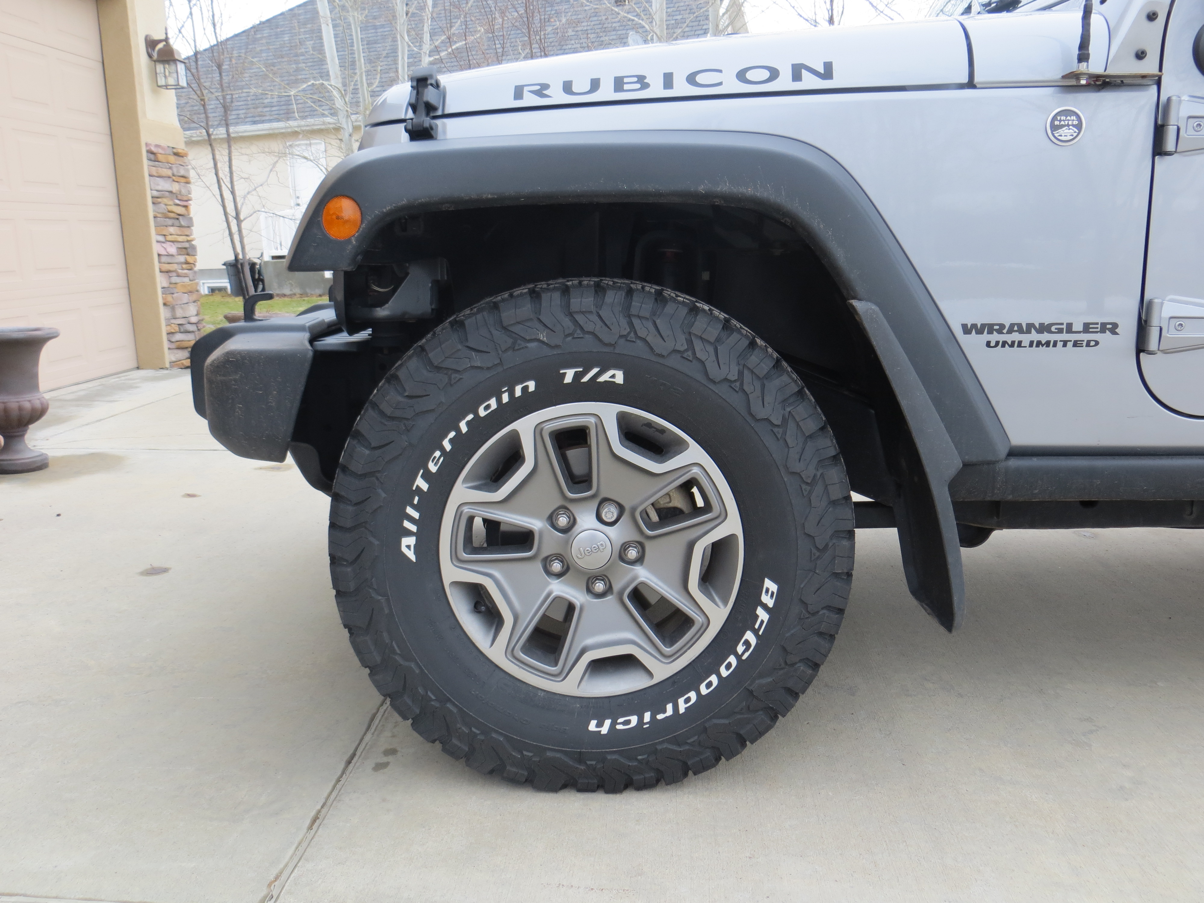

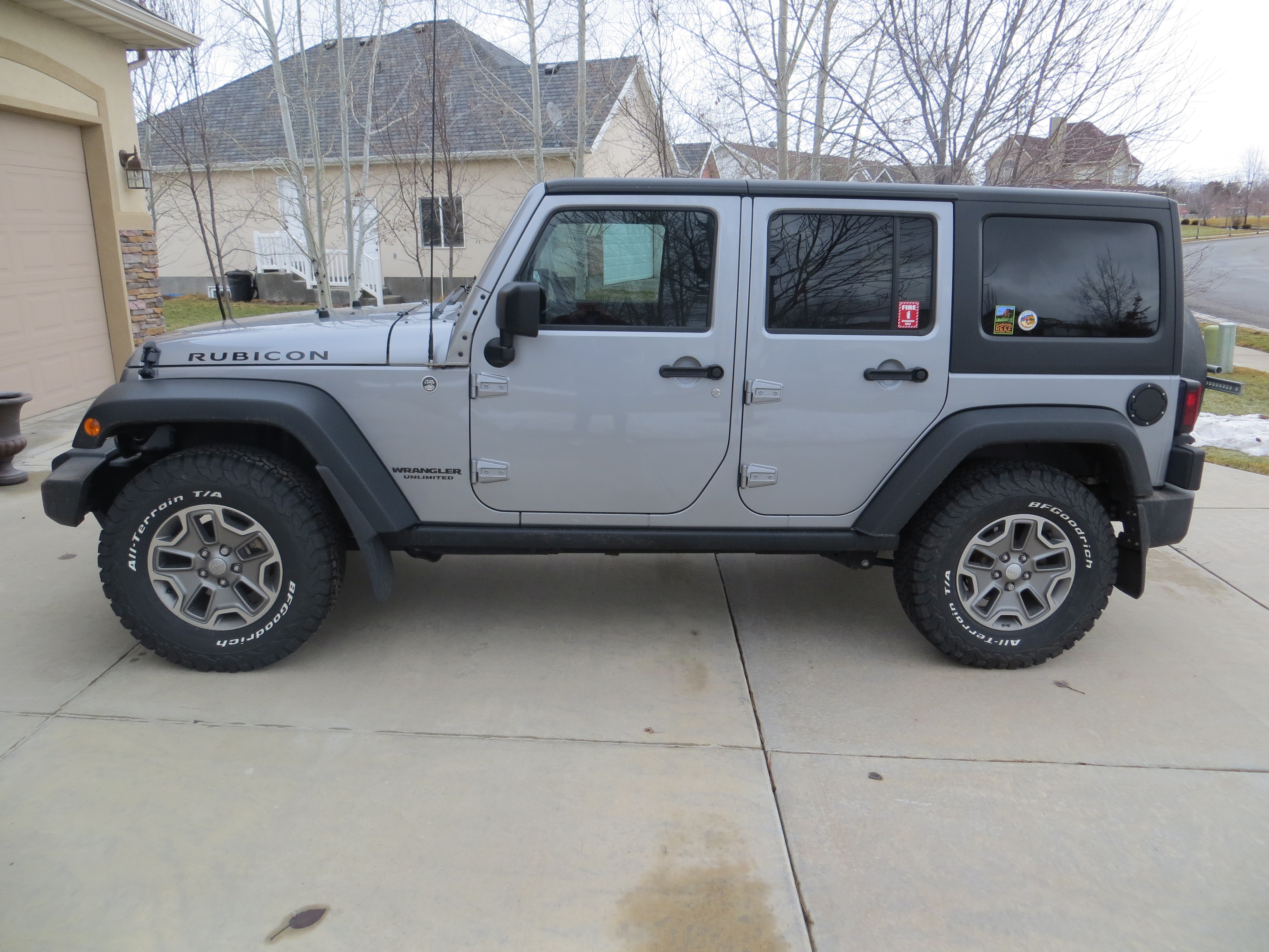

I just put these 285/70/17 KO2s on last week. Spec sheet says they should be 32.7 inch diameter compared with the stock 255/70/17 MTs spec at 32 inches. I measured the new tires (on the Jeep) at 32.0 and the originals (on an off-road trailer I have) at 31.5. I really like the new tires. Very smooth on the road, good snow/ice traction. The MTs had worn unevenly (rotated several times in 21000 miles) and vibrated, rough ride. Last time balanced one needed six ounces of weights. These tires haven't been off-road yet but I don't have any tire rubs or anything. GPS speed seems to agree with speedometer.

Did you add any spacers?

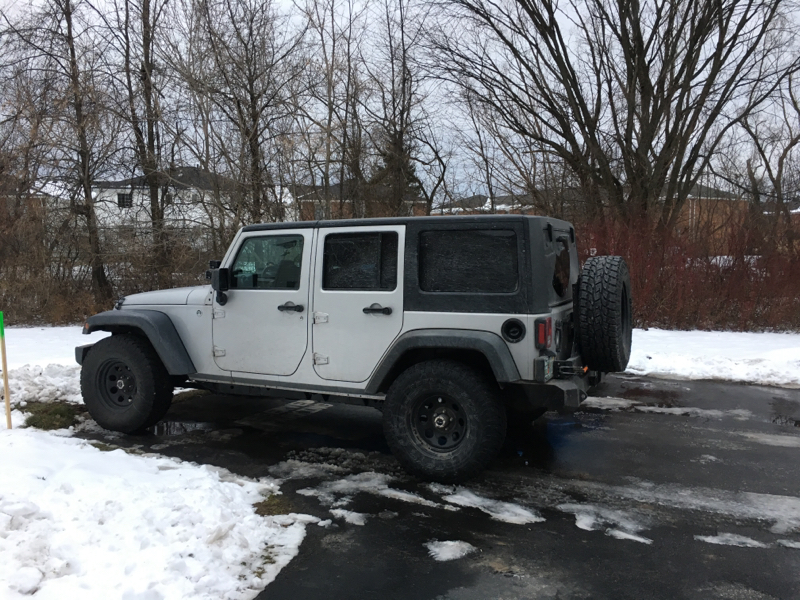

I have 285/75R17 currently on stock suspension until the spring. I did have to go with new wheels to prevent rubbing on road, however off road I get into the fenders pretty good. Setup is Toyo AT2 Extreme w/ 17x9 Vision Soft 8 (4.5 backspacing).

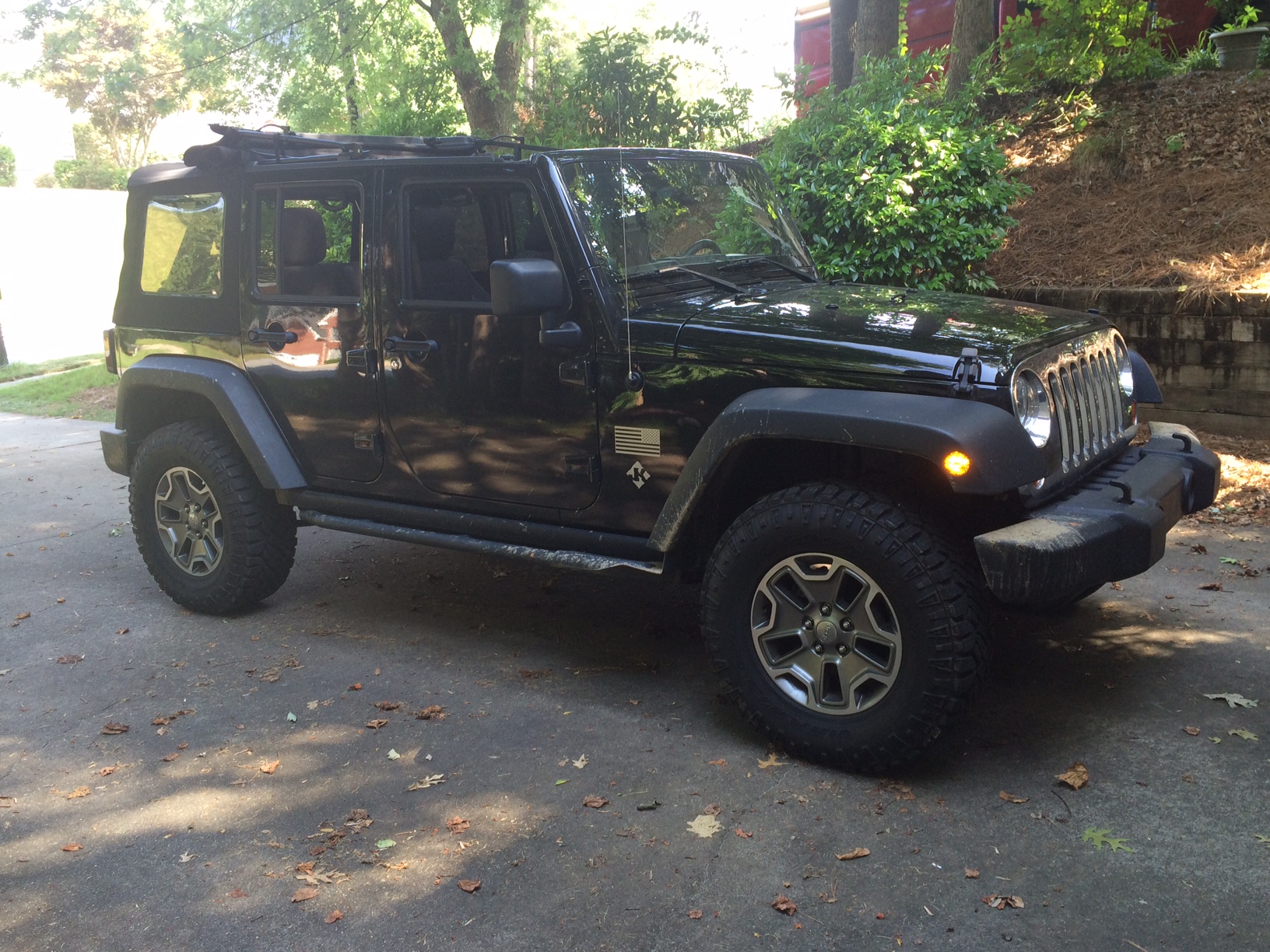

Duratrac 285/70-17s on stock wheels, Tereflex leveling kit, Spidertrax spacers

No spacers. It's a 2013 Rubicon so the springs make it sit a little higher than other stock Jeeps.

Would you rub without your spacers?
