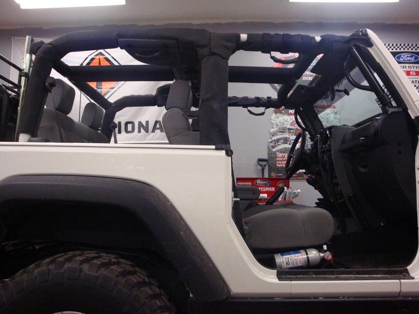

Sorry didn't get to it last night, but here you go.
I get very little flapping from the top.
My trail cover doesn't fit right though and allows rain to get in.
