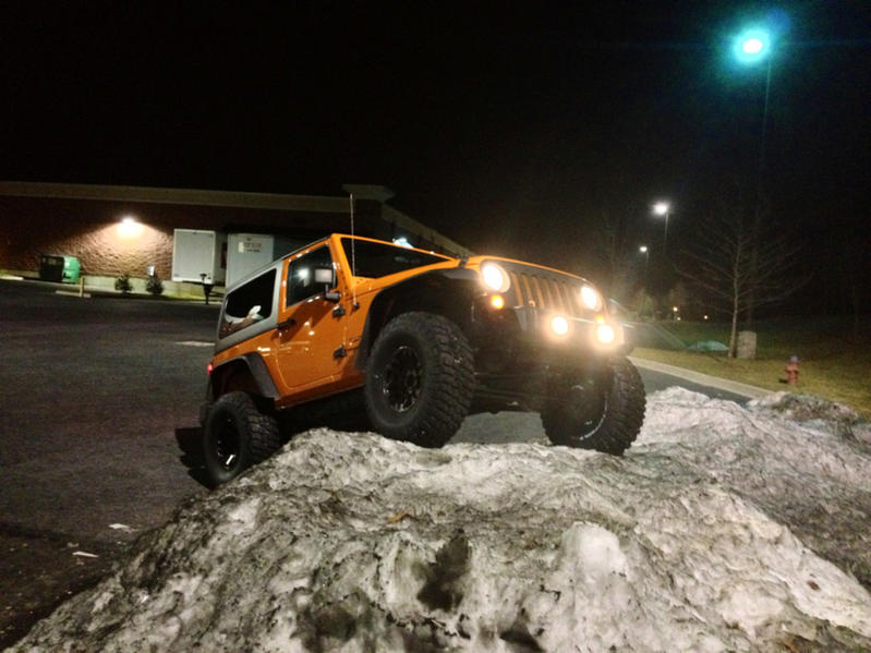

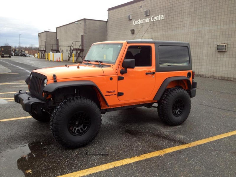

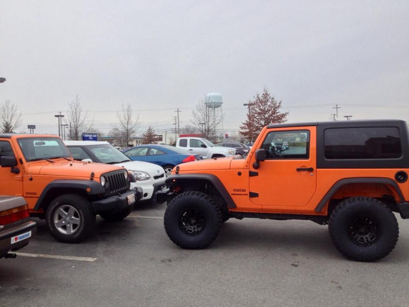

Don't be afraid tho, it's not that bad. Lol my neighbor has been on 37's, 3.21s, and a 3.8L for almost a year now. He lives and wheels pretty damn hard too. Do it looks WAY better than 33's

I'm surprised that thing even rolls.
