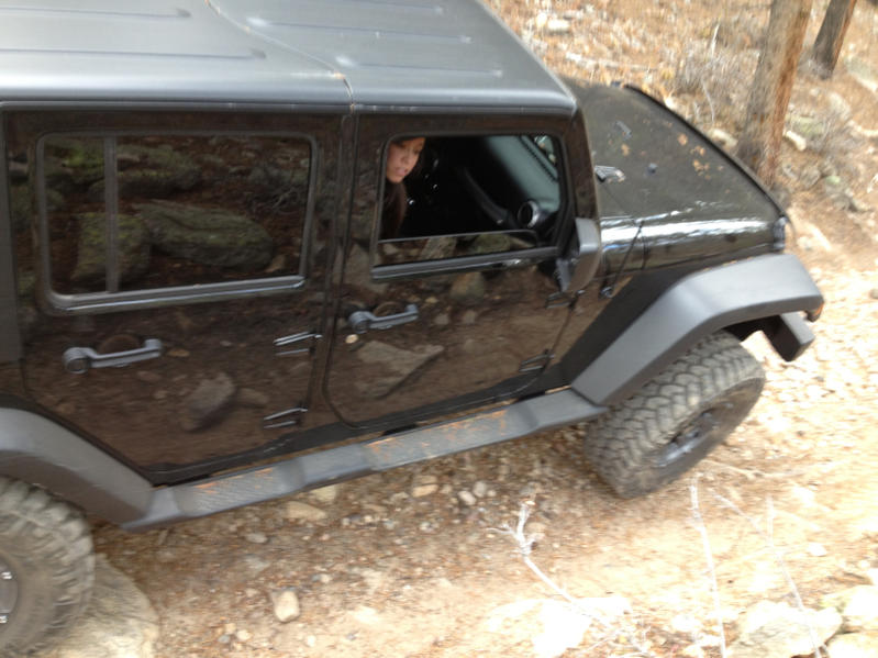

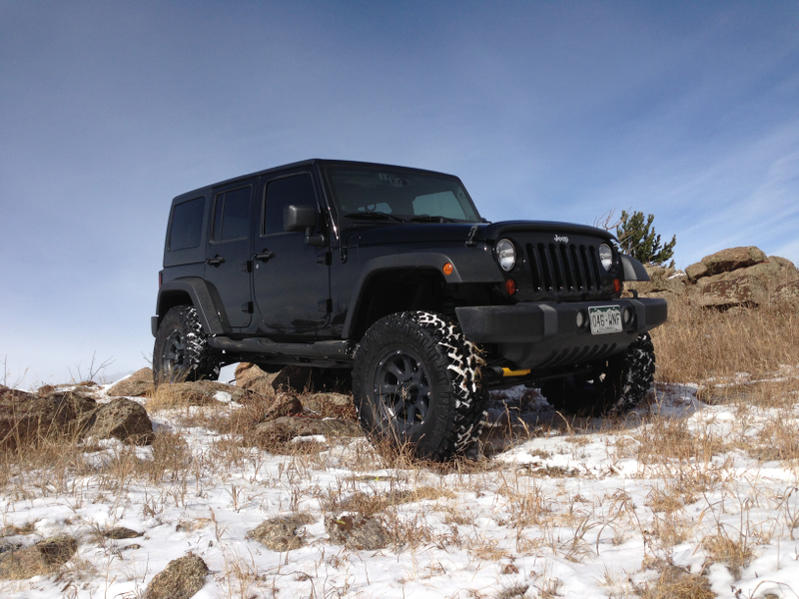

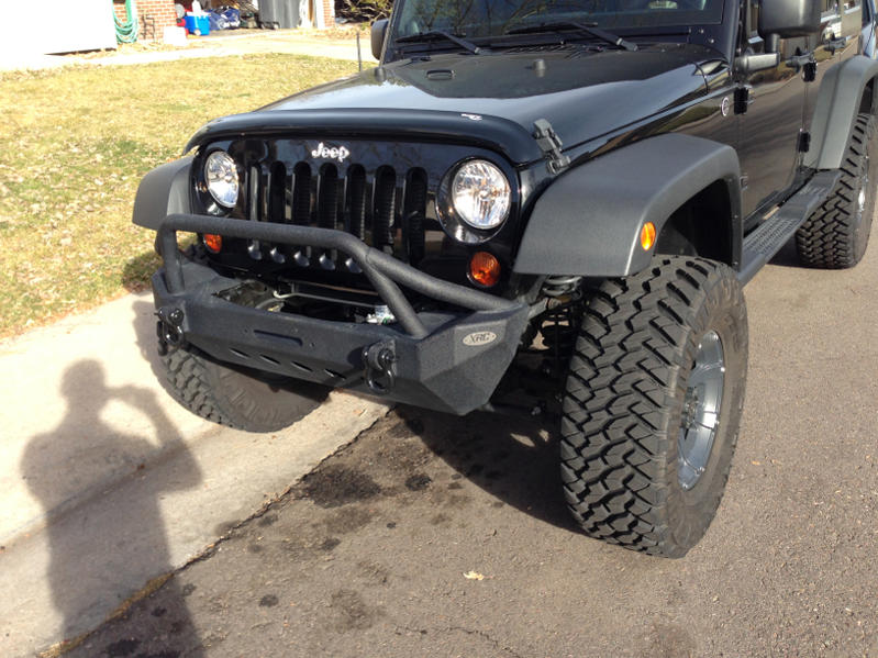

2012 JKU Sport 3.5 AEV lift, 35 inch Trail Grapplers, 3.21 gears. I am planning on upgrading the gears eventually but it is better than my 09 with 33's and the old engine. I've been running that lift for 4 months now and I am happy with its city and highway riding. I'm in Colorado and going up the mountains to snowboard is when I wish I had the better gears but that's what I'll invest in next. Also I haven't replaced the drive shaft either no problems yet!!

hmm, seems like you're doing okay without gears and driveshaft so it gives me some hope lol. I've been to Denver and I know that city is a lot of highway, any flighty-ness from it? Also, do you think your 2012 will be different from the 2013?
