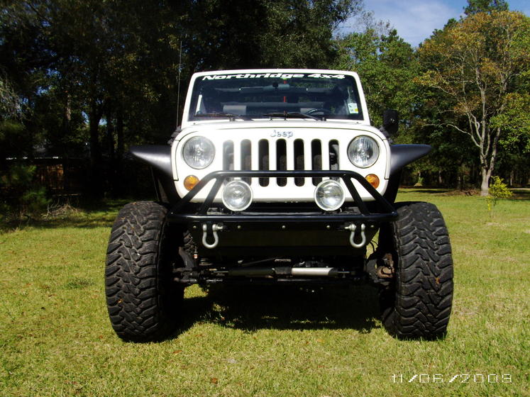

Crager 17x8's / 4.5 bs + 1.5in spidertrax, puts me at 3in of bs on 37x13.50's
Attachment 36128
Hey you have more pictures with this setup?
I ordered the 1.5 spidertrax - I am having my tires mounted this week - same 37/13.50/17 with fuel with 4.5 BS - I also have narrow fender flares
