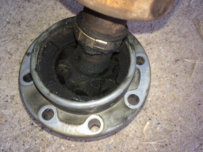

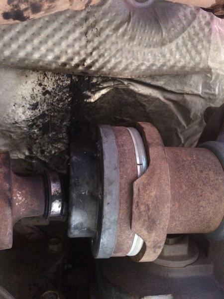

Old Feb 10, 2015 | 05:04 PM
CerOf's Avatar
Joined: Apr 2009
Posts: 1,331
From: Dallas, TX
You will need a new front shaft even if you never disconnect. Running at the angle will eventually cause the boot to fail. It will look like this: Click image for larger version
Sent from some string and a few tin cans.

Originally Posted by jmischen
I have an 09 jku and was looking into a 3.5 inch lift, what I'm wondering is at that height would I need to replace the driveshafts?
We recommend anything over 3.5" on a 4 door will want to replace the factory shafts. Obviously the higher you go the more angle is on them so 2.5" of lift is less wear and tear then 3.5" of lift would be on a factory shaft.
RK
