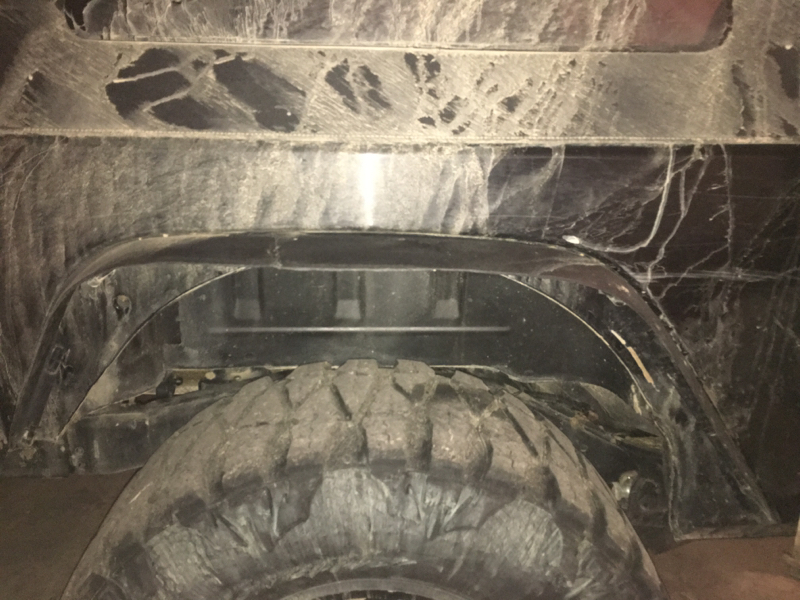

I went through dremel bits like crazy trying to cut with it. A jigsaw with a metal blade works really well lol. I cut a good bit out.

I run the 3.5 x factor on a JKUR with 3" of bumpstop. I took a BFH and folded over the corner of the rear pinch seam at the bottom. No rubbing front or rear with the control arms set to the length RK specifies. Still running stock fenders and the only place it rubs is under the very top of the rear fender which makes a little noise when flexed but hasn't damaged anything with quite a bit of trail time on it. This weekends project is to cut the fenders.
