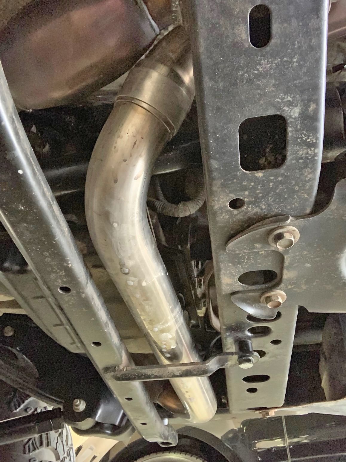

The Install:
The RIPP directions are easy to follow and their customer tech support was great. RIPP says it takes 4-5 hours for a competent shop to install but it took me all day with breaks for a few beers. I’ll admit I took my time and checked everything a hundred times. I’ve heard the horror stories about broken bolts on the JK manifold, so I sprayed the manifold bolts down with liquid wrench for two days prior to attempting to remove them. I’m not sure it helped, but all the bolts came out easily. The kit doesn’t come with new header gaskets and RIPP says to use the old ones. Mine looked questionable so I ordered new Mopar ones from Rock Auto. The left manifold had a slight crack I didn’t know about, so I guess installing the headers was a blessing since the cracked manifold would have to be replaced anyway. From here, I just followed the directions and the kit installed easily and it matched to my MBRP offroad exhaust perfectly. RIPP says to re-use the old O2 sensors, but I opted for new ones. When installing the sensors use anti-seize on the threads so if they go bad down the road you can get them out. From experience I can tell you they can be a bitch to remove. The RIPP headers throw some serious heat, so make sure all the O2 wires are well out of the way of the headers and pipes, or they’ll melt. The directions say to retain, trim and use the OEM heat shields off the stock manifolds. DO NOT SKIP THIS step or you’ll torch the plastic spark plug boots and wires. The RIPP tech told me to use some spark plug heat shield boots as an extra precaution, so I got the DEi heat shield boots from Amazon cheap. I didn’t install the HushPower resonator at first because I wanted see if it was going to be loud without it. Yep, it was loud. Crazy loud. I knew the wife wasn’t gonna have any of that so I installed the resonator. It takes a bit of measuring and cutting (of your existing exhaust piping) to install the resonator, but nothing too hard. The resonator is placed just after the muffler, which leaves plenty of room between the muffler and the first bend of the pipe before it goes over the rear axel. On 4-doors, you might have clearance issues with the evap canister, but by turning the resonator sideways to its shorter width side gives you plenty of space. RIPP suggests to weld the resonator on, which I did, but it can be bolted on. With the resonator installed the sound difference is amazing! The headers still sound cool, but they’re way quieter and there’s no droning.
