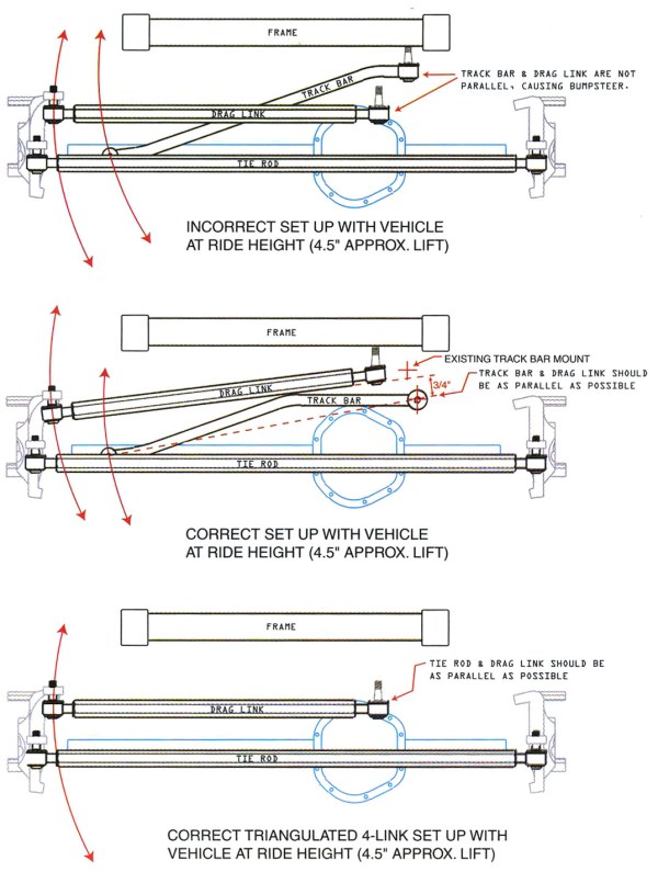

see attached pic(from knowledge center on quadratec's website)I have found I have less "bumpsteer"with 3"teraflex lift,teraflex adj trackbar ,stock draglink/pitman arm and superlift stabilizer,than my 2 door rubi had with stock components.my geometry and track bar shape is identical to that in attached photo and drives so well that I can stop here(good need money for tires/wheels)front end very nicely dialed in.wayof life is totally correct changes in pitman arm/track arm height must be equal,and why the companies that market this stuff do not properly address this.also claimed lift heights versus actual on most JK kits is so all over the map I would not trust a track arm drop bracket to properly center the axel.my "3"kit came out at over 4 1/2" an 1 1/2 difference would be noticable in track arm length
