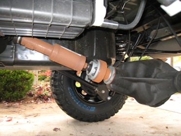

Finished up after another long day. This time I was at it off and on in between other Sunday activities. I took it out for a test drive and other than the slight rumble from the Procomp XMT it drives straight and vibration free. I did have to tweak the steering wheel twice to get it level. As a one man job it makes for a big project. I could have used a few extra hands more than once.
One minor point - I set the driveshaft angle even with the pinion. After I dropped it on the wheel, I checked the angle again and found that it had migrated 2 degrees up ^. It looks straight to the eye though. I will probably pull back the rear uppers next weekend to level it out.
I made a few mistakes that were easily corrected - mostly due to being tired. My wife came out a few times and just shook her head. She likes it though!
