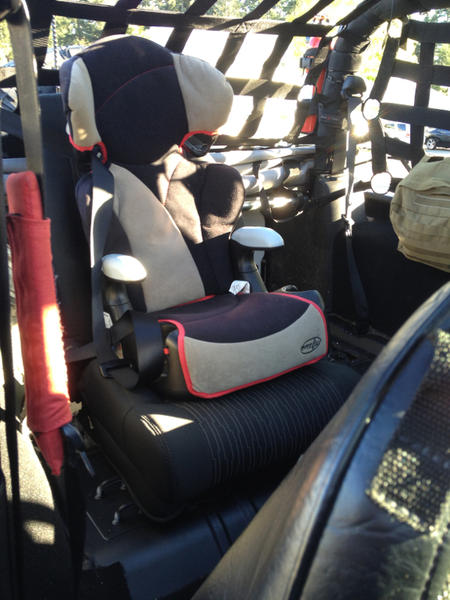

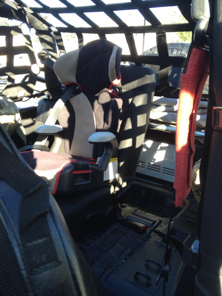

I did this exact thing for the same reason. I moved one of my front seats to the back and my daughter loves it. She rides a little higher so she can see quite a bit more when were out and about. It's not a hard install you just have to work around the gas tank for one of your mount points. I used large steel brackets as reinforcement on both sides of the floor pan. I can't remember the size of the grade 8 bolts I used but they were stout. Then I had my 200lb friend climb into the seat buckle up and go ape shit to make sure the seat wasn't ever going to go anywhere.
