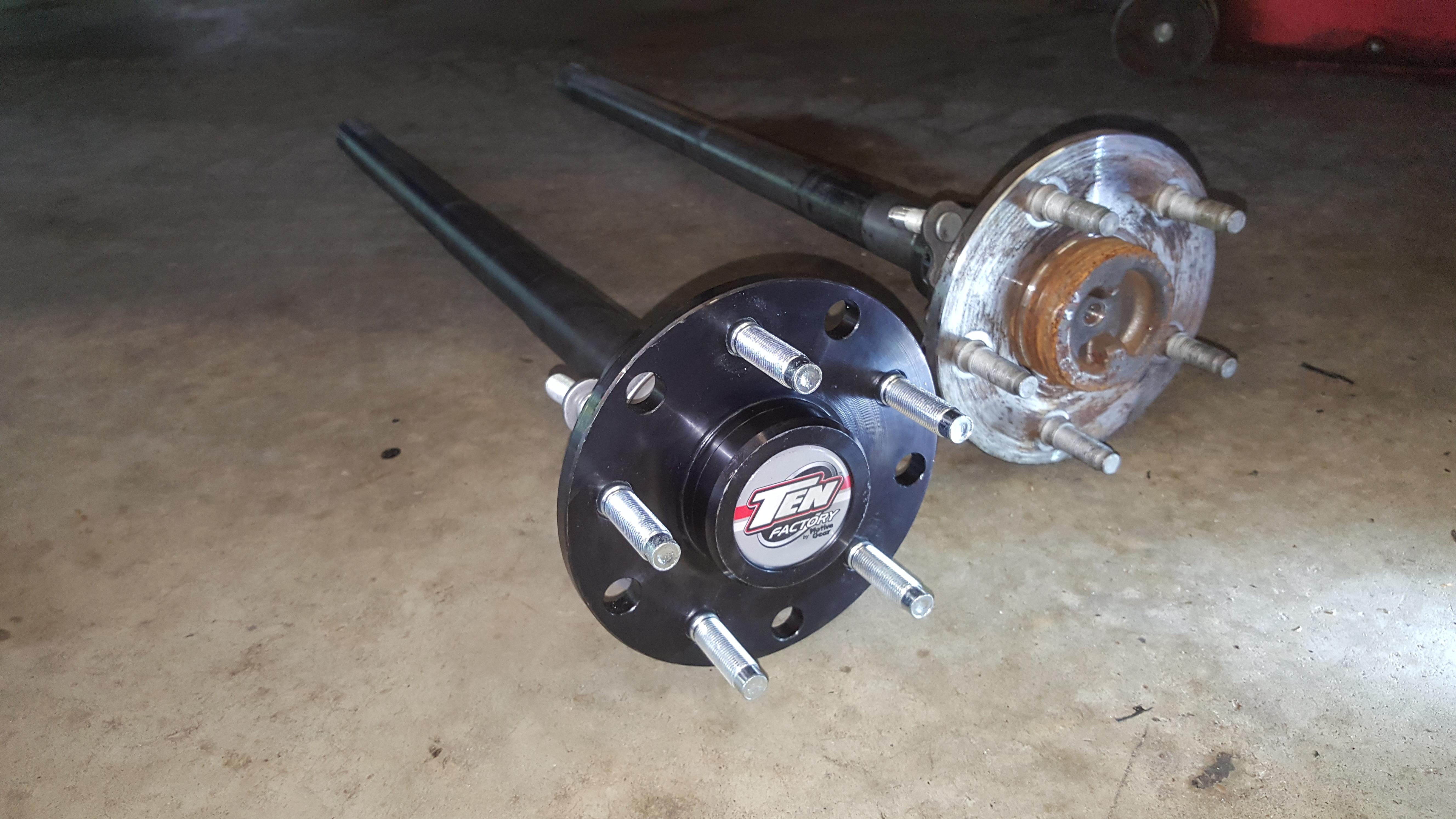

I went with RCV shafts in the front, and Ten Factory in the rear. I am running 37's and this should hold up fine with my current setup.
