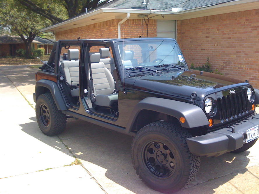

BFG AT 305 65 17 with no lift just 3/4 spacer on front -- O9 Rubicon Unlimited
ID:	24082   Click image for larger version
ID:	24083   Click image for larger version
thanks. just what i was looking for. you wheels even have the same backspacing as the aev pintlers.
cheers do you get any rubbing with that setup?
