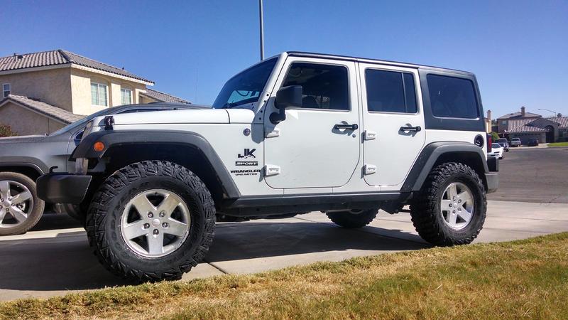

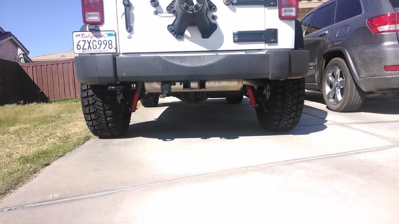

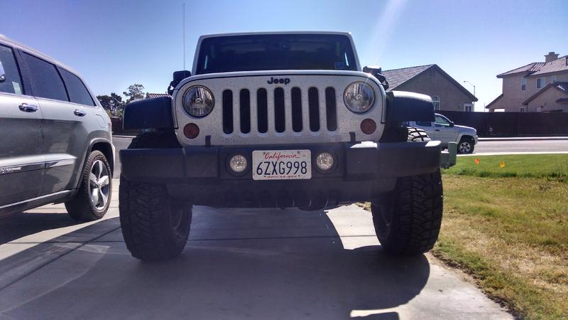

So I put them on this morning, and they look great. I will definitely have to trim the airdam and fenders though. Took it through some whoops at 40 mph and heard some rubbing in the rear, so fenders will be cut this weekend. Tire will not fit on the stock rear mount, so saving for a bumper/tire carrier next. Here is a couple of pics until I get more done this weekend.

Trimmed the airdam and fenders. I'm gonna stubby up the front bumper tonight. Exhaust, programmer, afe air filter, also done with the 34s, and the pants dyno says much faster than stock even! Many more mods to come.
