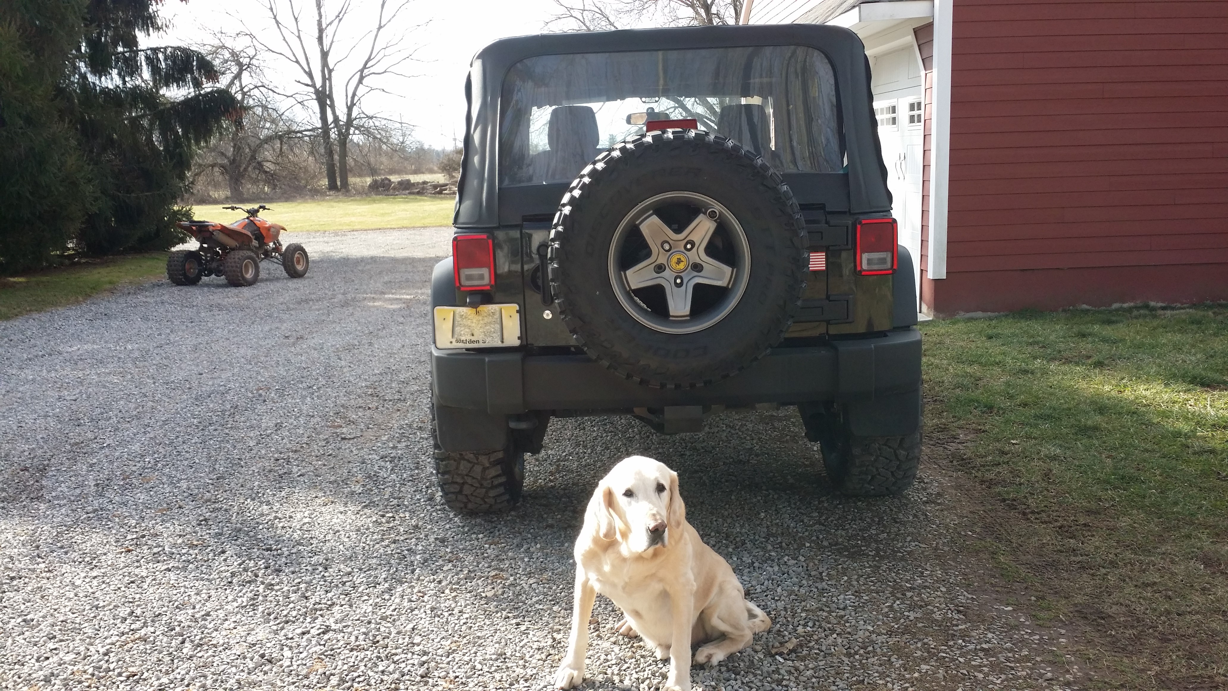

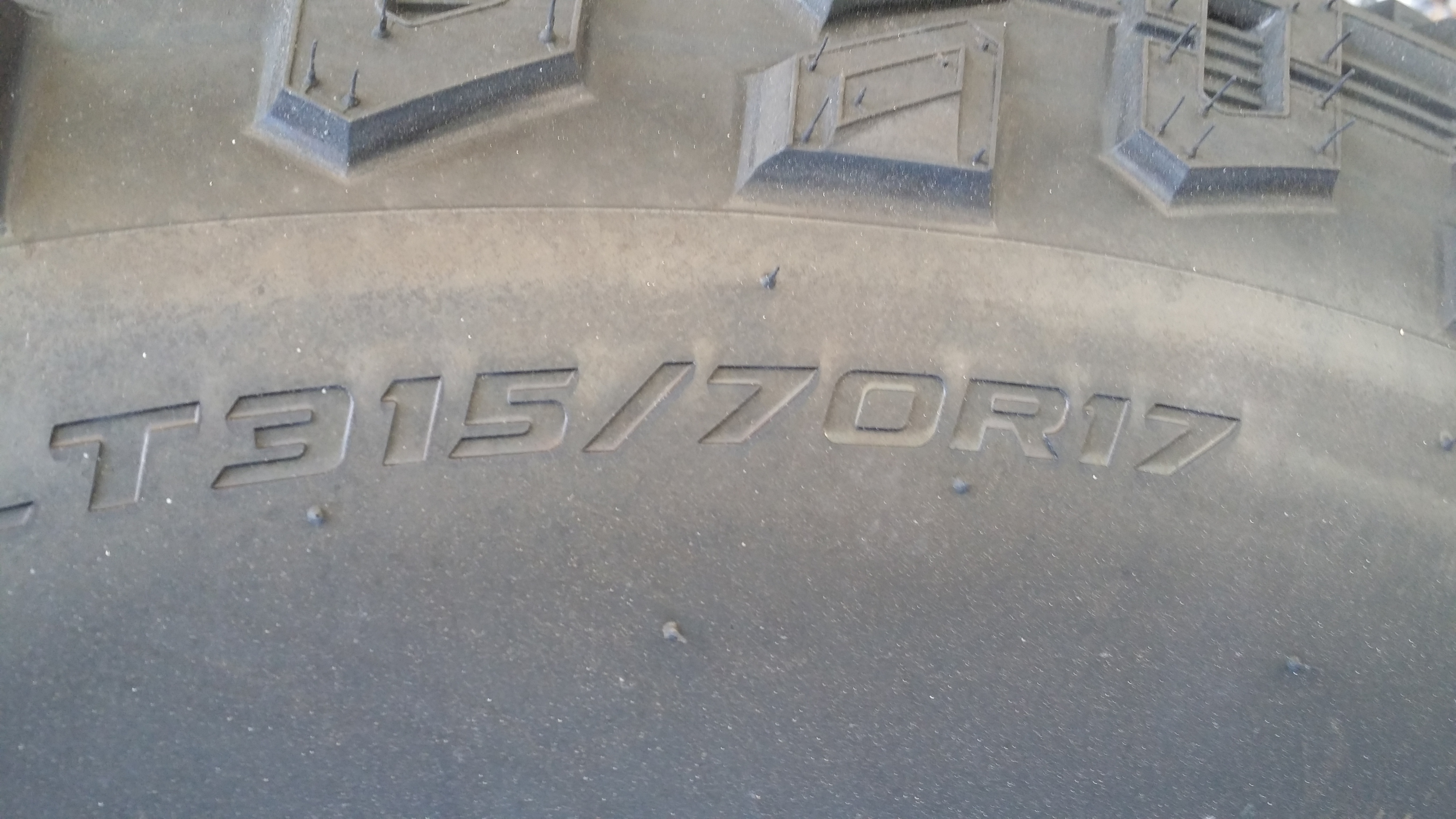

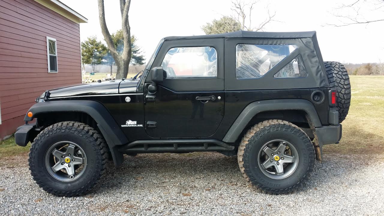

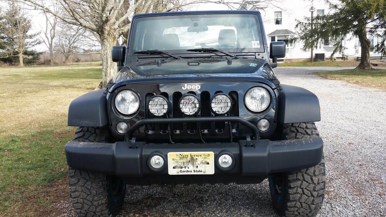

Here is mine with AEV 2 inch spacer lift and AEV Pintlers with 315/70r17 Cooper STT Pros. Pleanty of room and no rub at full lock. I think it rides better than stock. Did not have to trim the airdam on the 2016.
