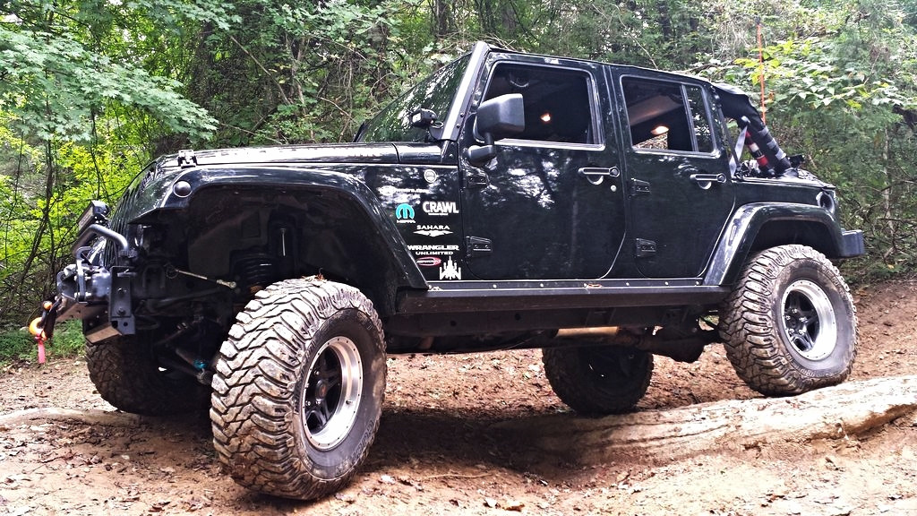

Originally Posted by PBone
I currently have 33 Duratracs in 16s and am upgrading to Cooper Discoverer STT in 315/75/16 on Wednesday. From what I've read they seem to last for a long time and are fairly quiet on the road. Check em out
you will not regret this choice.....until you desire 37's.......the STT in this size is e rated and tough as freaking all-get-out. Not crazy noisy nor wearing poorly after 20k - measured the other day ( I daily drive 40 miles and wheel hard on Tennessee granite 2-3 times per month) and they are only down to 17/20ths on the tire tread gauge..........four door weighs 4780lbs......loaded for bear w/ spare and hilift....run 28-31psi on street and 12-20psi offroad and you'll not be stopped by anything.....they are the meats....I just wish they hadn't ceased production on the 325/80r16 as I built my entire build around that tire in that size ( i like my 16 inch rims too much as they function as a pseudo beadlock when aired down ) so come Spring when I upgrade to a larger tire size I will have to go with something other than my beloved Coopers.....I also run them on my XJ......just my .02 cents on your purchase choice PBone....
<edit: forgot this photo is about 19k miles on the 315/75r16>
