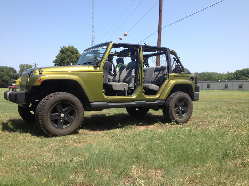

I would suggest getting the coil lift and shocks. The shocks will improve the ride quality over stock shocks. New coils will also improve ride quality.
You do say you are mostly highway, and couple trails. For looking at coil spacer vs coils, go with coils.
Don't worry about looking "bad" with your 33"s and 2.5" lift.
I'm running 33"s, had a 2.5" lift an loved it. Just traded that 2.5" lift for a 4" RC lift. I'll be running my 33" tires (measure to 31") with my 4" lift.
Here's my 2.5" and 285/70/17 BFG AT KO

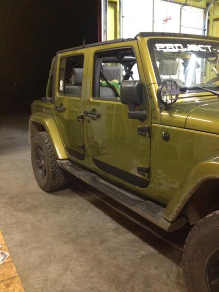

Here's my Jeep with the tires and no lift.
