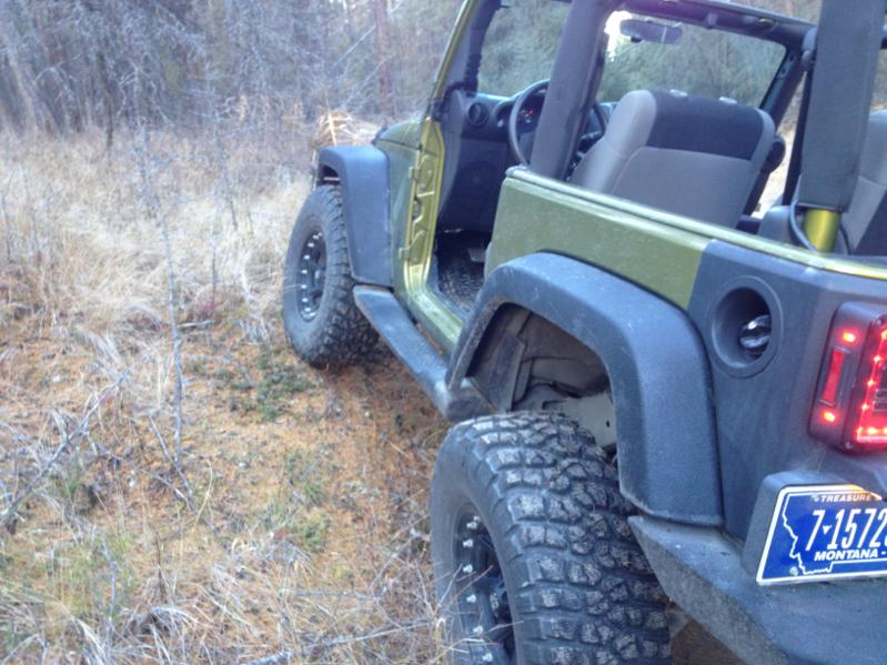

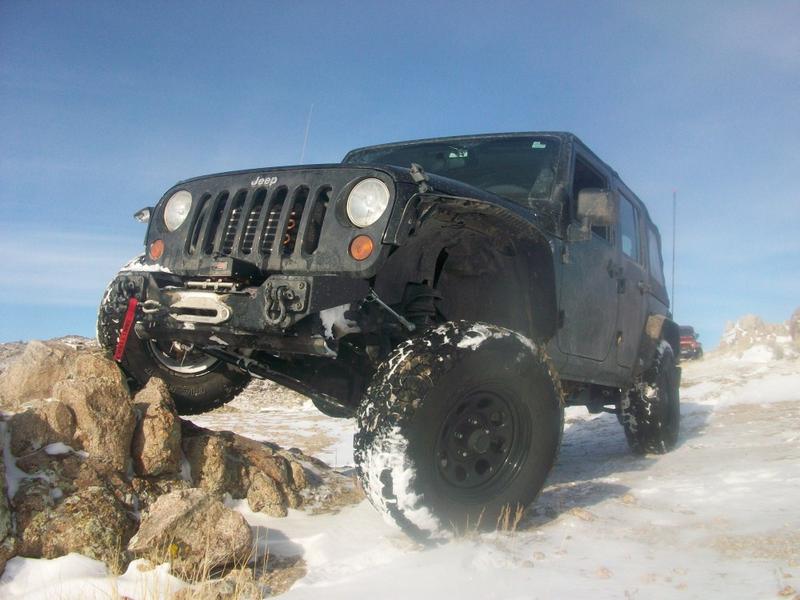

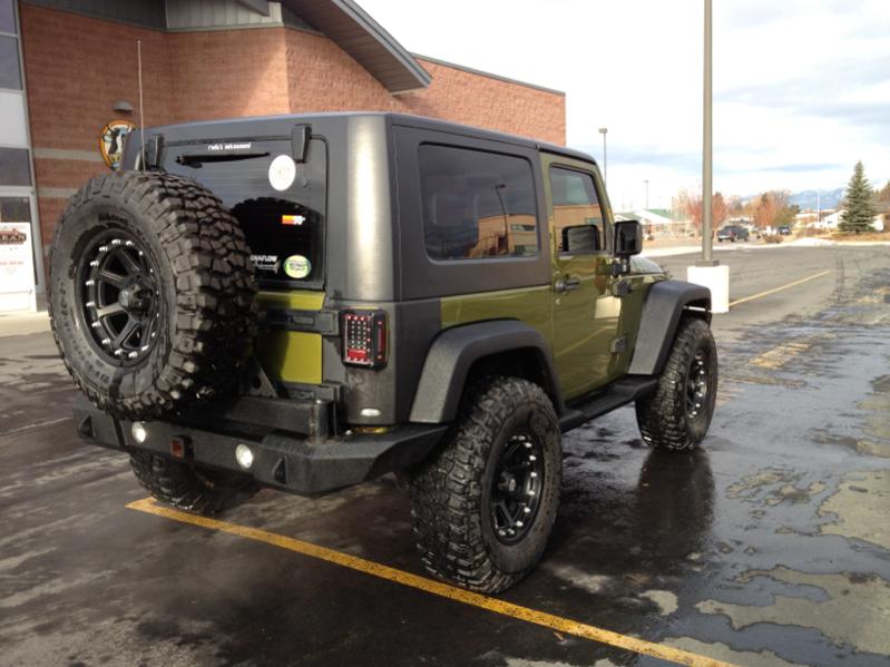

I have a 2dr on a 2.5 bb. I am rockin km2 35x12.5x17 and it's perfect!

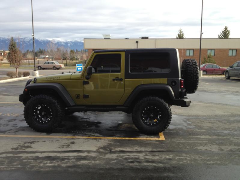

I'm running 285/75R16 (almost a 33) with a 2.5" coil spacer kit and I am with the guy who posted a few above me; I would rather be running 35's and will be when these shoes wear out, even contemplating 37's... I have heard and read that to not lose too much performance you'll want re-gear. I know when I jump to my next tires I'll be looking at gears, beefing up the axles, and lockers, but that's just me. It's all in what you intend to do with the rig, but for wheelin' it's always better to get the largest tire with the least amount of lift (keep CG low but gain as much clearance as possible). My advice, don't waste your time with 33's but again it depends on what you plan to do with your JK.
ID:	245741Click image for larger version
