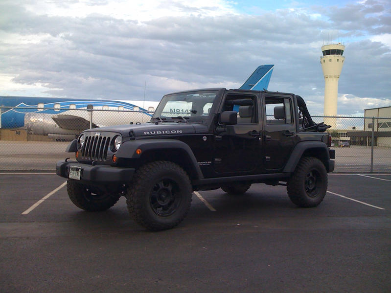

This was prior to a lift and 35s.
It was the TF leveling kit and 285/70/17 KM2s. The fronts had a very minor rub at full stuff. Sounded horrible, but never had any damage.

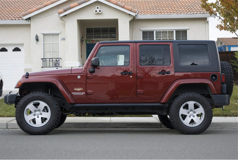

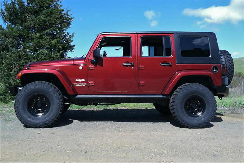

OP- do you wheel or is for looks? 33's will have minimal impact on performance in acceleration, mpg and braking. 35's will increase your running ground clearance over stock by 1.5" but you take a hit on acceleration, mpg and braking. It's really your call.
Here are pics of 33's and 35's on a 2.5" lift to give you a idea.
