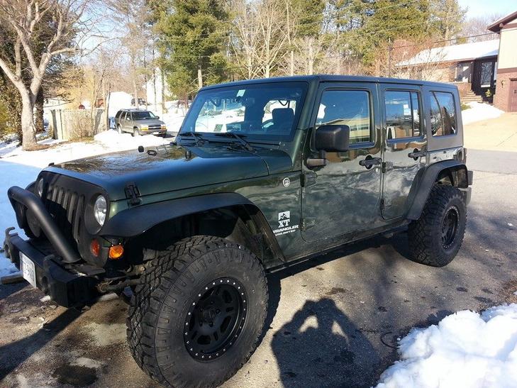

you'll need 1.5" spacers on stock wheels... here's mine on 33's before my lift, but I had already cut my fenders ... I've got 3:73's and mine is fine on 33's... You've got the 3.6, so you'll be fine!
