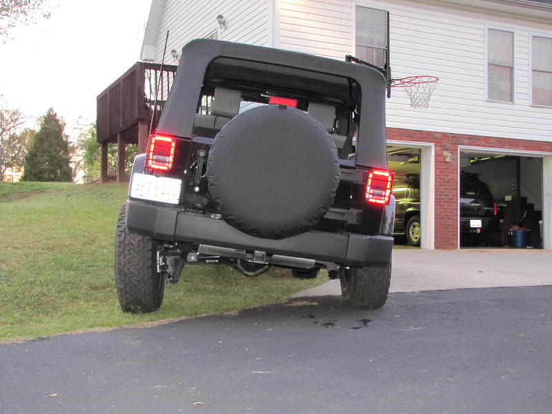

I've got the 1.5" TeraFlex Performance Leveling Kit (springs) and 33" BFG ATs. I have MB72 wheels with 4.5" Backspacing. I rubbed on the skid plate mentioned above on reverse turning only so I removed it.
I have no issues on the road, but rub on my back fender flare at the 12:00 position (inside the flare) and 2:00 position when flexing. I am about 1.25" from the pinch seam (that thing scares me). I think I'm going to solve this with Bushwhacker Flatties and trimming the pinch seam (for peace of mind).
To answer your other questions: No spacers here and I get around 16.1 on the gas mileage.

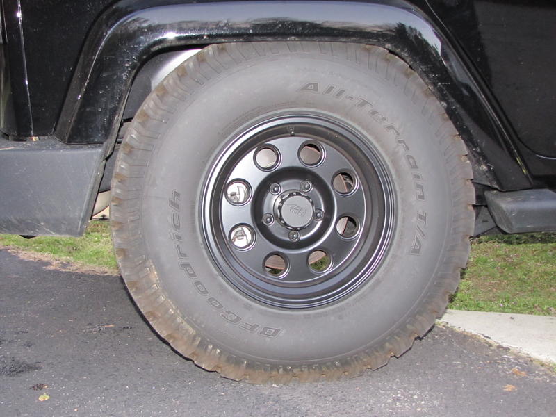

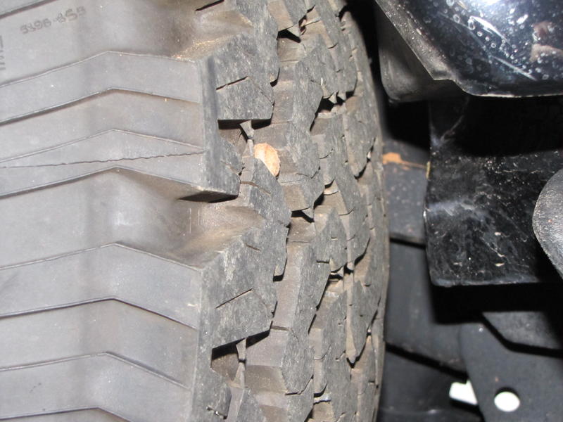

My Set up:
2010 JK Sport
1.5" TF Leveling kit (Spacers - 2" up front, 1" in the back)
285/70/17 D rating BFG AT KOs
Stock Moab Wheels
PSC Brawler Lite Front Bumper (Just so you know I don't have the air dam)
So far I've only noticed rubbing on my front sway bar at full turns in either direction, but more so when in a full turn to the right.
My MPGs went from an avg of 16 around town down to 12, but there is a lot of construction and traffic jams in my area ( not to mention my auto start on the cold days). On the Hwy I got 19 mpg, so far (short trip).
