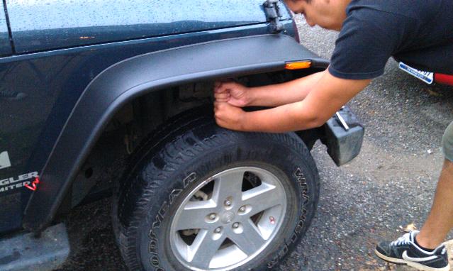

Hey everyone. Just had a quick question to see if anyone has had and experiance with the matter. I found someone locally that's selling micky t's 34 inch baja for a pretty good price. I know a stock jeep can fit 33s no problem... I swapped the flairs for the bushwacker flat fenders and i see I did gain clearance but i dont know if i am missing something (spacing wise) ill post up a before and after Adding the flairs

This is with them installed

I'd say you'll be fine. Go find something to flex-test it on with the swaybar disco'd and you'll find out.

Cool thanks for the quick reply. I was just worried there was gonna be rubbing issues. It's not like I'm going to be doing heavy Offroading until I fully get my lift this winter or spring

My 35's measure to 33.9, I put them on bone stock and drove around for a few weeks, they'd rub the flares, so I cut the flares.
Then when flexing pretty hard the'd come up and hit the pinch weld in the rear or the top side of the fender in the front, so I added a 1/34" 175 dollar daystar spacer, no more rubbing, and all this was with NO bumpstops.

One more thing, they'll be rubbing (at full steering lock) the plastic shield that hangs from the bumper...My 2C's, take it off and throw it away.

^^In regards to this, and I forgot to ask, what wheels are they going on? a/m? your factory ones?
Either way, just get em, put em on and see what happens. Hell if they contact the rails just don't turn your wheel all the way until you get some spacers

With the flats and some spacers you should be good for normal driving
