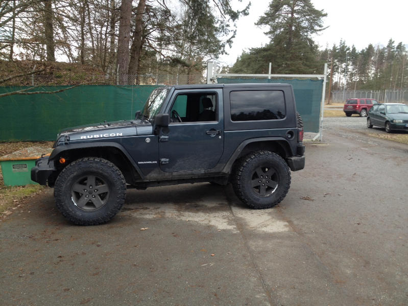

I have 35s with 4.10s no noticeable difference on road with manual
