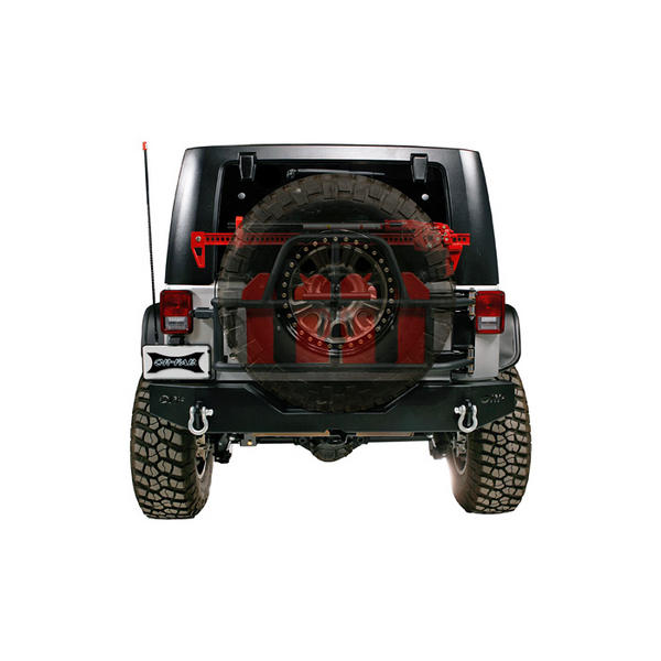

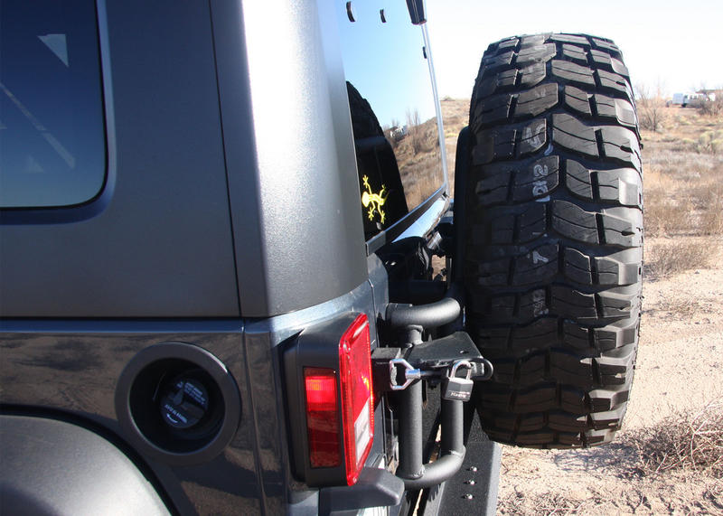

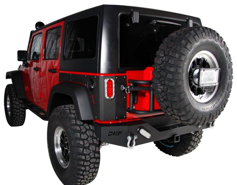

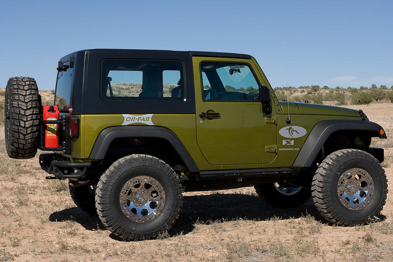

Check out OR-Fabs tire carrier that can hold up to a 37" tire without changing the factory bumper. It has a mount for a hi-lift jack and a cb antenna. It comes in 3 options; 85208 Tire only carrier, 85207 tire can carrier (has room for 2 5 gal gerry cans), and 85209 RotoPax carrier (comes with 2 3gal RotoPax.)
