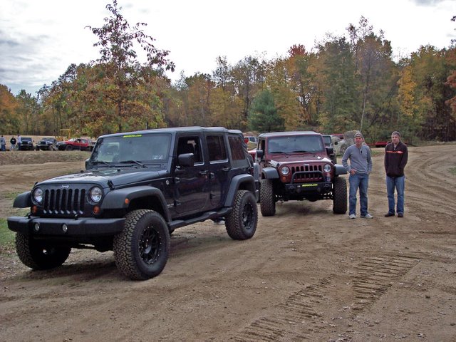

check out my project jk under my screen name on here, i've got pics for ya. and they offroad fine too, but i don't do anything over the top..

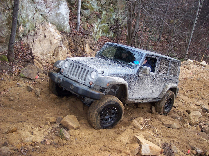

Mine don't rub at all. 4.5"BB with 315/70R17 and I disco. Mine is the blue one, and my friend has got the same setup, but with 16's. Check out the flex disco'd
If you get the Teraflex, spring for the shocks and don't get the extensions, I broke my original shock studs on the front trying to get them off. You can't get the originals at an autoparts store or jeep. I luckily had a buddy with a JK with the originals shocks he took off when he got his BB.

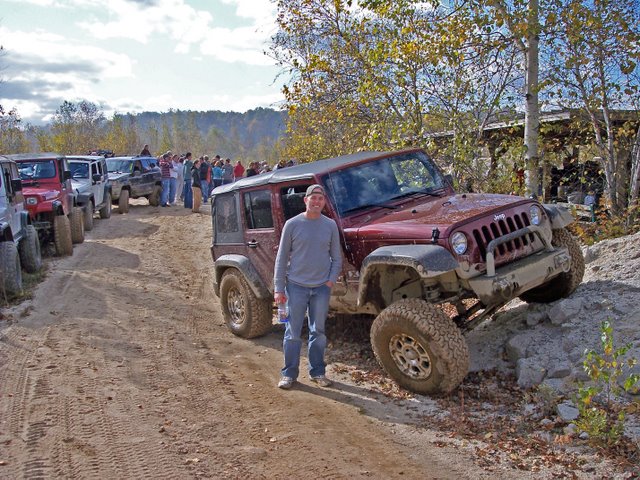

TeraFlex 2.5BB with shock extensions and 35" (315/75R 16) ProComp Xtreme M/Ts on 16" ProComp Xtreme Alloy 7089 ..
