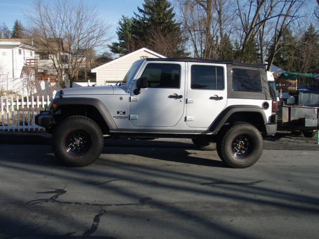

37s fit a 4 door perfect, They should have came from the factory with the 315/70/17.
Some pics for you
2.5" lift 315/70/17- 34.4" 3:73s
Same lift and gears drove it for 25,000 miles till i traded it in, Cut fenders added 37s huge difference at first but like miked said it looks proportional.

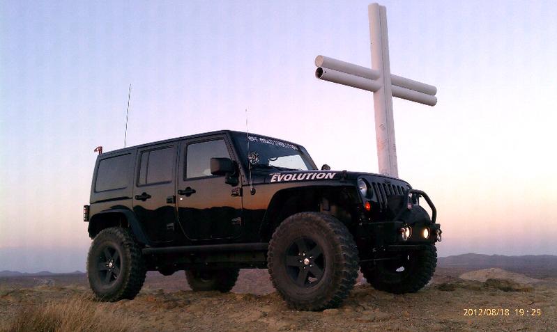

Go with the 37" km2's, I did from stock rubi tires. U will be glad that u did, cuz if u have 35's and u see a jk in person on 37's u would have wished u got 37's instead. I parked next to WOL's jk Moby which is on 40's and I already want 40's now lol
