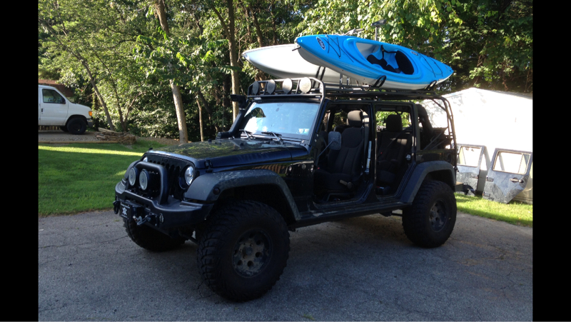

Originally Posted by ricky-2012jku
Hello, I'm not really looking for which is better nor pros and cons. But would like to ask a question about why there is such a negative view of 35's on 15's. But not 37's in 17's. Each set up is the same ratio. I've been on the fence about upgrading wheels or just getting 35's for my 15's. The only real negative that everyone seems to think is possible squishy ride and handling due to extra tires. I haven't read that about the 37 on 17 setup. Why is that ? Many guys run 17s with 35's. But I just don't see how one more inch of rim and one less inch of tire could possible affect the ride or handling to the point that it would be noticeable. Am I missing something? I almost feel as if it's just one of those things where owners think something because it's been said so much but who knows either way thanks for any responses.
I run 35s on 15s with a very heavy / top heavy JK and I have no complaints about it feeling squishy. Does it feel different then the stock 32" KMs in 17s, yes but any size change isn't going to go completely unnoticed.
