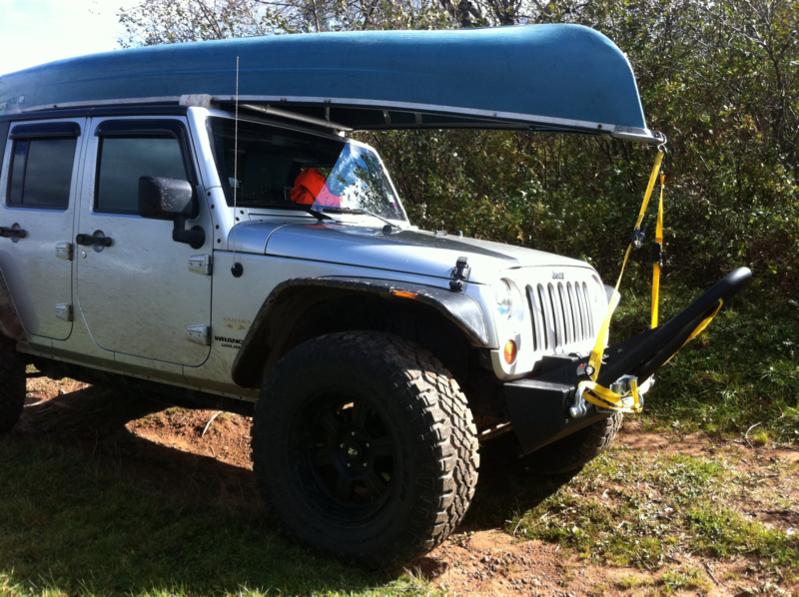

Tf 2" extended bumpstops in rear and your golden.
These pics have tf puck leveling kit, 325/65/18 duratracs, bw flats.
