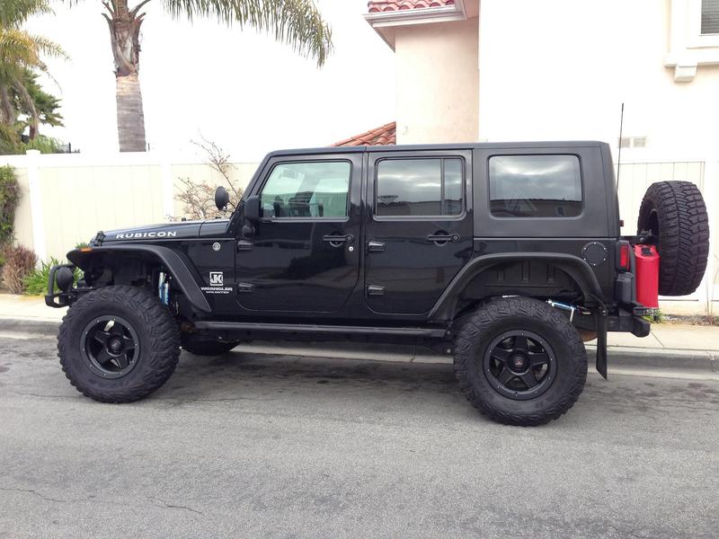

I'm close to what you have, but also got a body lift. I rub slightly with a 5/8 rear bump stop and a 1" (hockey puck) up front.
Plan on changing my springs to AEV next time around. The JKS's are a little stiffer than I need

The reason why your rubbing is you dont have enough rear bump stop. Try putting a 2.5 inch extension back there and you shouldn't rub

Monte417,thank you. But I like hitting dessert trails at 50 mph. When I got my tires I fully flexed it and 3/4" was to much of a gap to the pinch seem for me. Then when I got the King shocks, I had to do 1" in the front. It awesome off-road and I do like my 4" inches of up travel. The city is what got me leaning to the AEV's softer ride next (maybe).
