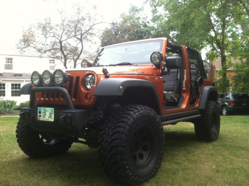

AEV 4.5" with 37s, 4.10s and love it. I do need to regear, but don't regret 37s at all. It's my DD too
