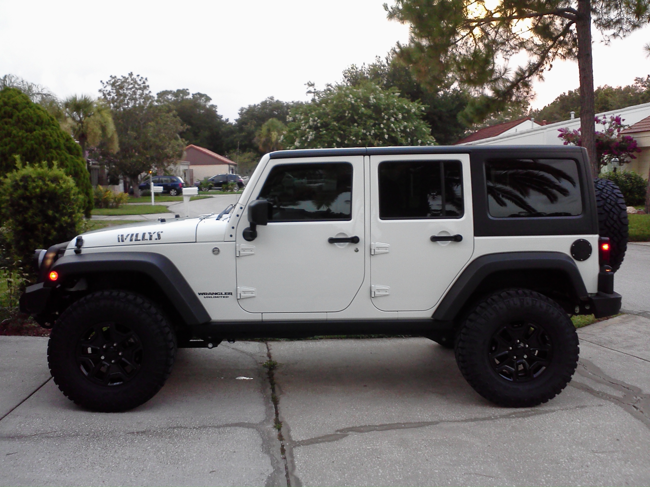

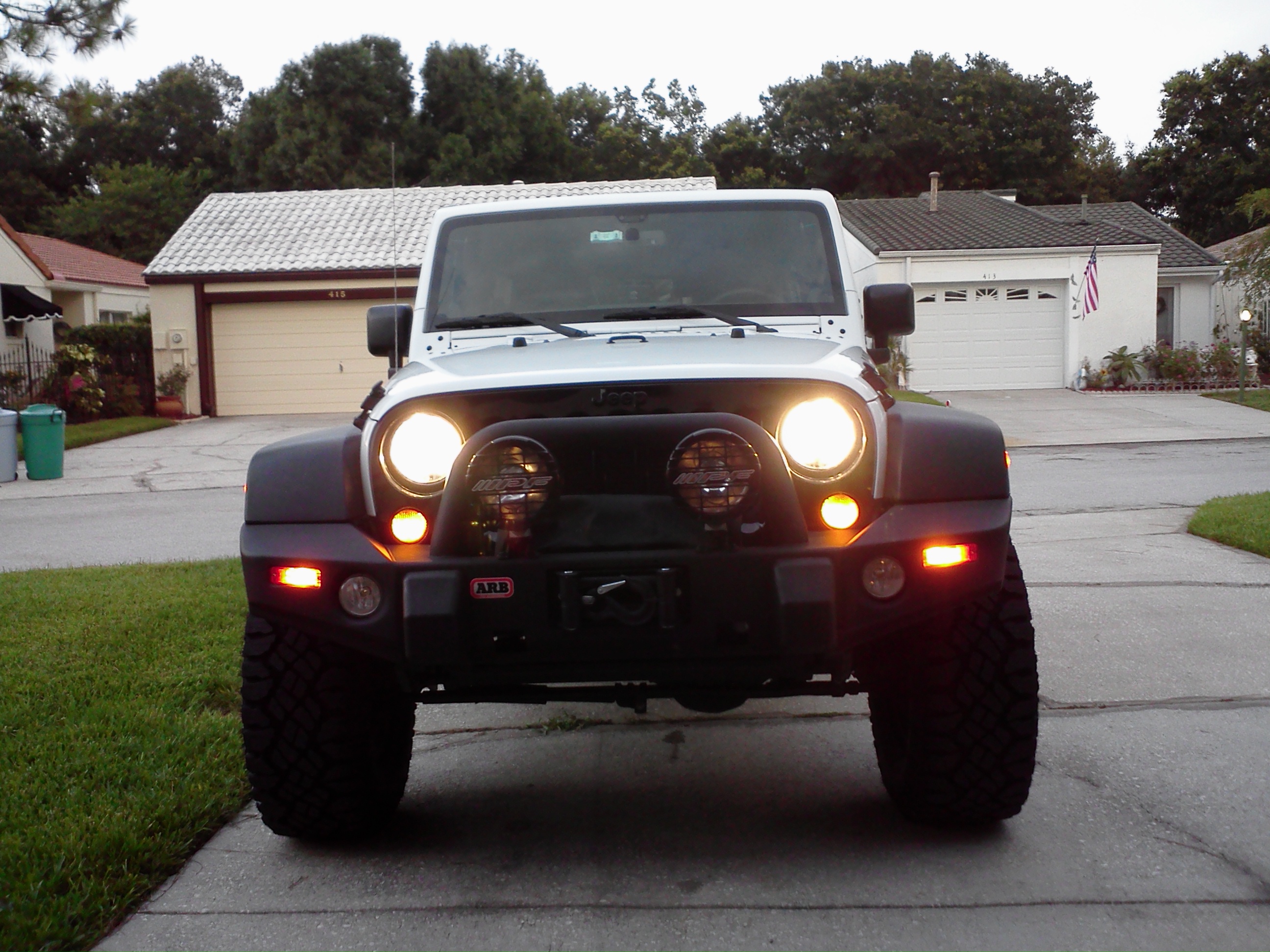

Yes, you will need 1.25" or 1.5" spacers front and rear. In the rear you will not be able to mount 35s without spacers because you will hit the lower control arm. I used Spidertrax 1.5" black spacers front and rear for my factory Willys Wheeler Wheels and Goodyear Duratrac 315/70/R17. Do not buy cheap spacers make sure you buy quality and use the included Red Loctite. Also if you have Factory Mopar Rock Rails you will need to trim 1" off the end for clearance for the 35" rear tires.
ID:	622993Click image for larger version
