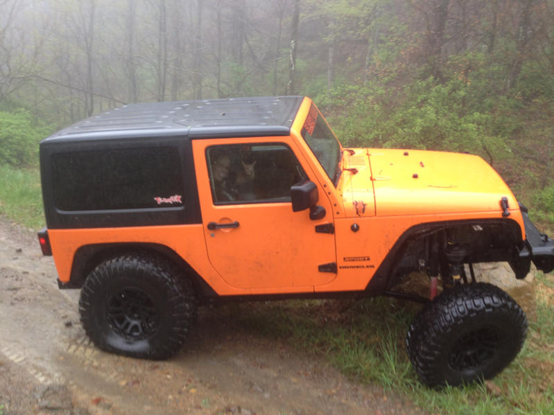

Originally Posted by QPJEEP420
I've got a '08 JKU with a Teraflex leveling kit. Running 33s now, looks like i have room for 35s. Anybody running that setup? All i've heard says i need at least a 2 1/2" lift to run 35s. Also heard i needed at least a leveling kit to run 33s, but i ran them with no problem before i put the kit on. What do you guys think?
QPJeep,
I run a 2" leveling kit on my 2-Door with 35" tires and they fit just fine. I plan on getting a set of flat fenders and trimming my pinch seams do that I cna disconnect my sway bar and not have to worry about rubbing anything.
I only have rubbed twice, and that was because I was on some pretty bad frame twisters. So, unless you plan on doing some pretty hardcore wheeling a 2" leveling kit will be just fine for you.
Here is a picture of my Jeep with that setup.
Please let me know if you have any questions. I'll be more than happy to assist you.
