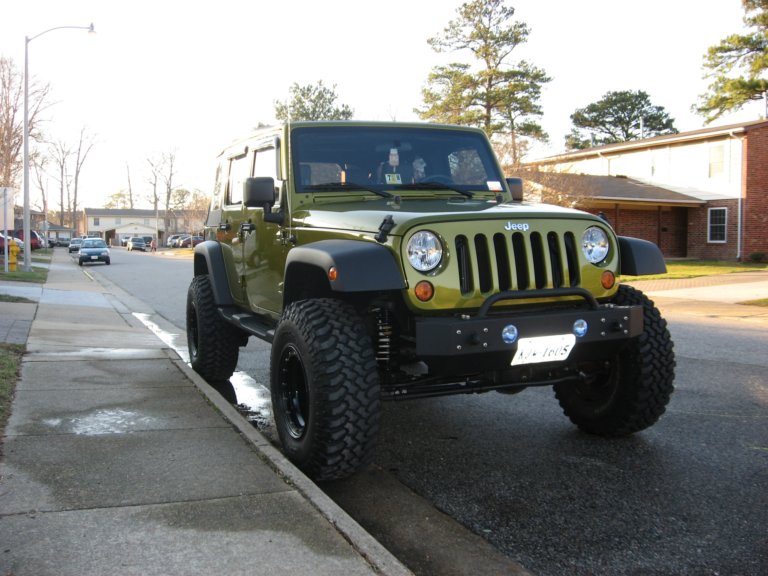

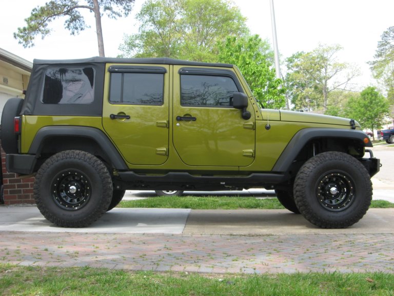

x2, my wife is running a rustys 3.25 with 315x75 r16 on a 16x10 wheel, with the rim combo she has some rubbing but not that bad, i tried to talk her into 16x8 but she likes the way 16x10s look, and she only will do moderate offroading, so no worries...
