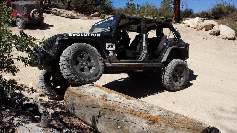

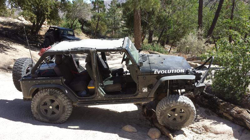

Im running 37/12.50/17 bfg km2's on my stock moab wheels with 1.5" spidertrax wheel spacers. No problems at all

Yes, those tires will work fine on them as long as you use spacers. You may have trouble finding a place to mount them though.
