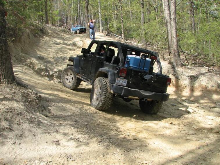

I'm running 35" Toyo's on stock rims, 2.5 lift, and 1.75" spacers. I really don't notice any balooning. In the pic below I have them at about 16psi.Click image for larger version
