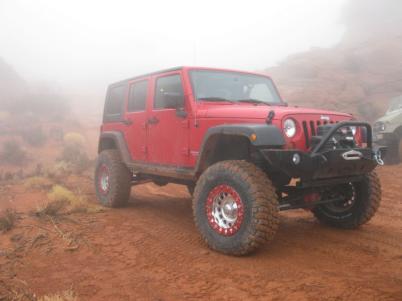

I run 37s, auto and 5.13s. I wish that I had gone with 5.38s. You will definatly not be in OD driving up anywhere from the LA area. It will look awsome and be great on the rocks. You will want a long arm lift it you want it to ride nice, which I think a DD should. In the rocks you either gearing will be fine.
