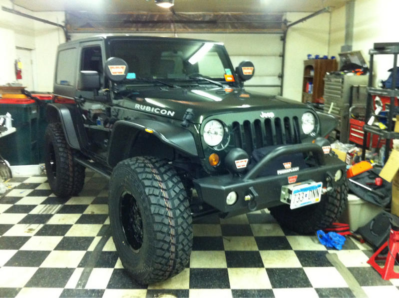

I was wondering if anyone (and I'm sure there are plenty) was running 37" MTR's? I have 37" BFG km2's and they measure 35.5 when there siting on my jeep. I was wanting a bigger tire a I was told the MTR's measure true to there advertised size. I was hoping someone could please measure a MTR mounted on there jeep!

I run 37x12.50x17 with 8.5" wide beadlocks on my JKUR. They measure out at 36.3" on Jeep @29psi; rig weighs ~6,000lbs. They are pretty close to 37" on the spare without weight. They are definitely taller than my buddies 37" BFG MT's.

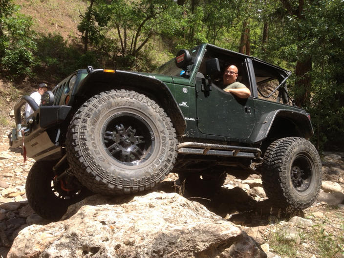

I own a set of 38x13.5x17 and yeah they aren't bad. Loud tire and but I like them a lot. If your running them in snow and ice I suggest to cipe them though.
The 40's are about $7.00 more per tire.
