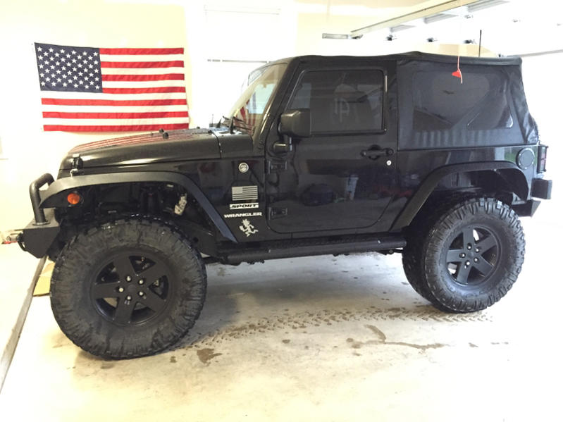

Just got done installed my 37x12.50x17 nitto trail grappler on my 12 JK with a 18/59 spring setup and tf budget boost. So far so good, we did have to trim the pinch weld on the rear but other than that just bolted right now.

Could you grab some pics of how close the tires as in reference to shocks and other components?.. With or without wheel spacers?.. would be helpful. Thanks

Diff with 1.5" spacers if not when you turn you would hit the frame.

Well done .. Just shows you don't need 4" of lift to run a 37
